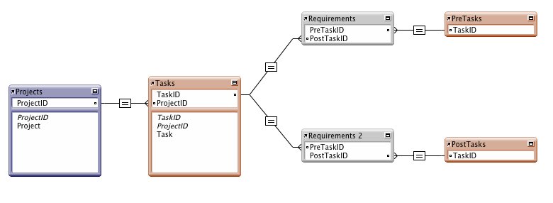

You won't be able to create new tasks directly by typing in the prior tasks portal - because the portal is to the join table. I'd suggest you begin with establishing the correct structure first, and worry about the UI later. Here's what your graph should look like, more or less.
Great, very helpful. I've set up that structure; a few items about what I've done so far / questions (if you have the time, that is):)
1) The two Requirements TOs are join tables with foreign keys; the fk's related to the Tasks TO are formatted as Drop-down lists using a value list sourced from the Task TO, TaskID field.
2) The fk's related to the PreTasks and PostTasks TOs are formatted as Drop-down lists using a value list sourced from the Task TO, TaskID field (or the PreTasks and PostTasks TOs?).
3) The PreTasks and PostTasks TOs are based on the Tasks base table -- or are they based on separate base tables?
Thanks, Ken
There is only one join table (Requirements) - it has two occurences on the graph. Likewise, there's only Tasks table, with three TO's.
The foreign keys linking to the Tasks TO can be set automatically (just allow creation of new records in both Requirements TO's from Tasks). The other foreign key, linking to PreTasks/PostTasks can be set to use a value list. So you only need to select the "other" task, in order to create a join record.
As long as the value list is NOT set to use only related values, it doesn't matter much which TO of the Tasks table you choose. I would pick the "main occurence", i.e. Tasks.

Brilliant example file, that made all the difference in the world. I had many mistakes related to which TO the fields were displaying data from, and I had the TOs of the portals on the Tasks layout reversed, i.e., I thought PreTasks (PreRequisites) belonged to Requirements 2, because PreTaskID was related to Tasks; however it is the other way around, because PreTaskID of the Requirements TO is related to TaskID of the PreTasks TO (and vice versa). I will continue to study this until I get it well planted.
