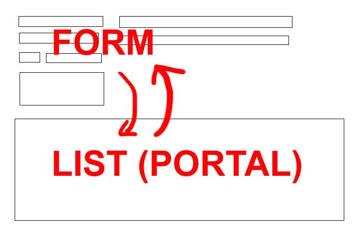

I want to create a hybrid view; form and a list on one layout. Portal seems perfect, but the problem is, it "wants" to show data from related tables only, not the same table.
How is this layout can be achieved?
Thank you.
You can create a relationship to the same table, by putting another occurence of the table on the graph and linking the two.
But your wish can be achieved much more simply by putting the 'form' in the header part of a list view.

It works, thanks to your help.
