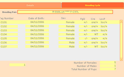

this is how my database is
one file contains all the information about mice that we are working with. the information contains.. parents, date of birth, sex, colour, tag #. Now i am making another database that gets the information from this first database and puts in another database that organizes it according to the breeding pairs. I have a portal in the second database that gets the information from the first database based on the breeding pair (parents). The portal also gives information about the sex and date of birth of mice from that certain breeding pair. I need to summarize the number of females and males from each breeding pair. I used the formula given by "comment" and it works only if i have another field in the first data base. I wanted to be able to count the number of females and males using the portal and not have to make another field in the first database.

Here is the picture of the portal that i need to do calculation for.

Sorry, here is another try!
If you look at the picture i have attached you can see that the portal has fields called
Fgl2
Cre
LoxP
I need to be able to summarize how many of those records have
Fgl2 = +/- ,
Cre = Cre/+,
LoxP = lox/+
So basically I want to write formula that would be something like {Count(IF Fgl2 = "+/-" & Cre ="cre/+" & LoxP ="lox/+")}
