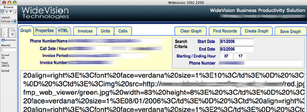

I have a script that populates a field with HTML and then web viewer will display the page.
However, there is a slight delay in the web viewer displaying the HTML as it should - so it displays the HTML as text in the web viewer window.
While it only displays it for a half-second, it will be annoying to my clients (as it has been annoying for me).
I have tried to freeze the window until the very end of the script, and then I do a refresh, but it still shows up.
It also happens as I scroll between records (as the HTML field is a global field) - so is this just a web viewer glitch?
Any information is appreciated.
Thanks,
Tony
Hi Tony,
I had the same problem.
What I found out was, that the "WebViewer-displays-html-as-text"-thing depends on the lenght of the html-source.
ULRs can only have (I think it was) 2k of text. Maybe that's the problem.
I solved it, exporting the HTML-source to the harddrive and set the webviewer to that temporary HTML file.
Regards,
Horst
I wasn't aware of the 2k HTML limitation. So, I will stick with just loading it from the hard drive.
