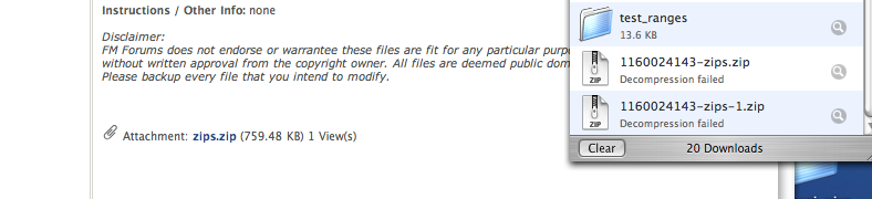

Ok, so the other one was too compressed and nobody could open it. basically, I have a file that needs all the work done to it. Why? 1.) because i can't figure it out. 2.) Because it would be a good tool for people to have.

Zip File doesn't correct :
:? How is it supposed to correct, if you put it an invalid zip code it comes up "no match"
Look Att
Ok, Sorry. I had to use the maximum compression allowed in order to get it to fit the forum file size prerequisites. When i get home i'll put it on a file hosting site for every one to view. But first i have to make changes because i found some good information on finding the distance between zips based on latitudes and longitudes. stay tuned until tonight!
