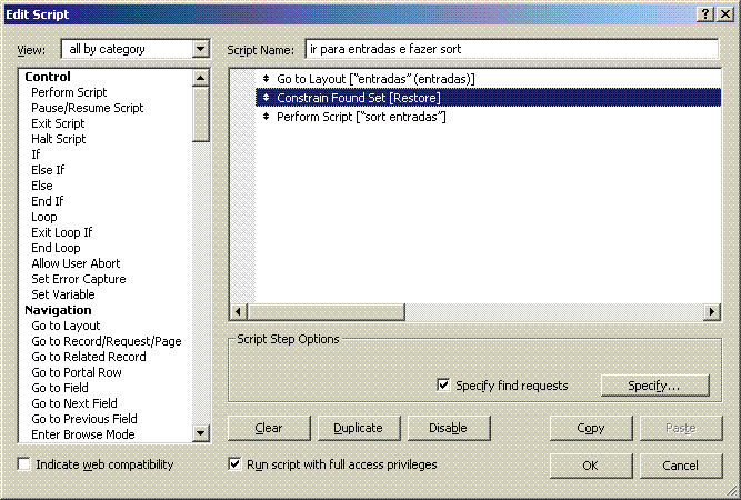

I try to make a script like this
thumb_1160697613-1_script_omit_no_access

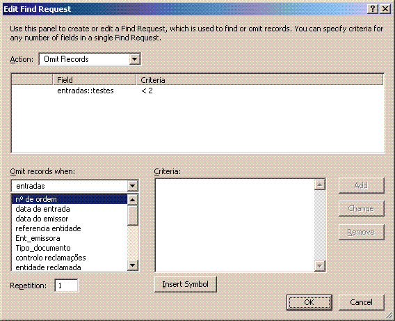

and then the criteria wich is the value contained in the calculation field based on Get(RecordAccess)Function in Filemaker
Well the script is linked to a button setup in the main layout wich serves to reach "my records" layout i reach the layou but all i see is all the records
