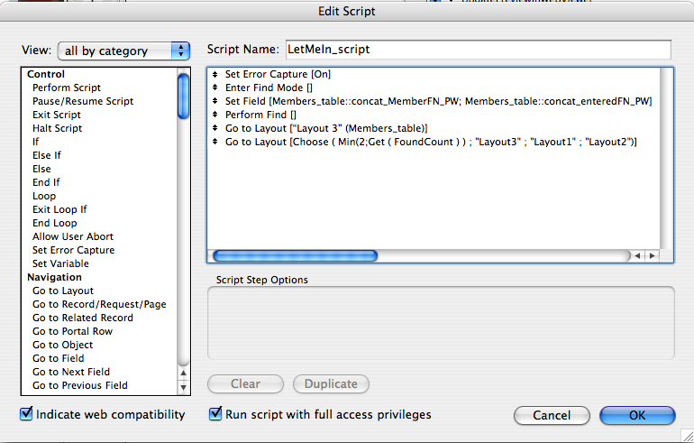

Many thanks for your speedy reply. I tried what you said, and it worked except that at the end it didn't 'redirect' to the appropriate Layout 1, 2 or 3. It just stayed on the 'original layout'.
I am attaching a screenshot of the script as I entered it, in case I have mistyped anything.

NOTE: I've just realized that the attached screenshot shows the last-but-one-step as "Go to Layout 3" -- I did that as a test, and it worked as showing that the script was getting to that point. But I really have "Go to original layout" at that point, and that's where it stays!!
Silly mistake!
Make sure you change the formula I gave to the exact names of your layouts. I didn't have spaces in "Layout1" "Layout2" etc. Try "Layout 1", "Layout 2" or whatever the actual layout names are.
Also, make sure that you are using the "Layout Name by calculation" option, and not "Layout Number by Calculation."

It was doing that to me too. It appeared that the calculated goto layout doesn't work correctly immediately after a find. That's why I inserted the extra Go to original layout step between the find and the calculated Go to. That fixed it for me. It appears to be a bug in version 8.5. I will report it to FMI as soon as I find the bug report link.
You could also just try the following script:
if [Get(foundcount)=0]
...Go to Layout[Layout 3]
else if [Get(foundcount)=1]
...Go to Layout[Layout 1]
else
...Go to Layout[Layout 2]
end if
