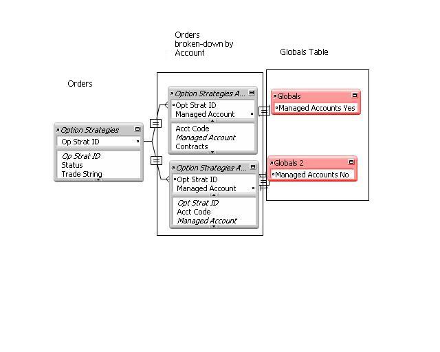

The only difference I can find betweeen the example and mine is that I have another link between the tables, the order number. That is why, I originally tried using a separate table for the global filter field. That also gives me the same blank portal. I have attached a screen capture of the relationships in that arrangement.
Hey Bill!
I don't believe a structure (like that in your screen grab) is gonna work, unless your layout is based on the Globals table, but I don't think that's what you're trying to do.
Using a self-join relationship, as you started with those 3 table occurrences of Option Strategies, you'll need to have the "Yes" and "No" constant fields in the same table. Then it's merely a matter of defining those relationships with the constants.

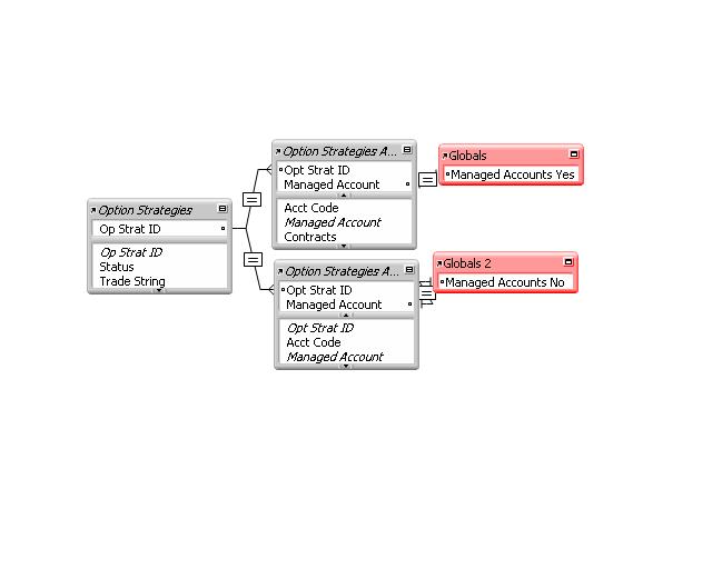

Is this what you mean?
Hi Bill:

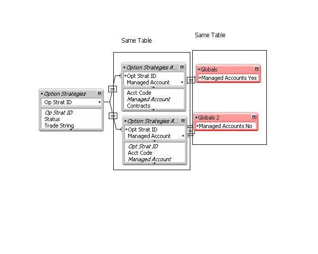

Not quite. I couldn't detect any difference between your first screenshot and this latest one.
... in the same Option Strategies table ... not in a "globals" table as your screenshot indicates. If you downloaded that example file referenced in my first post, take a close look at how those relationships operate.
Hang in there! You're gonna get it!

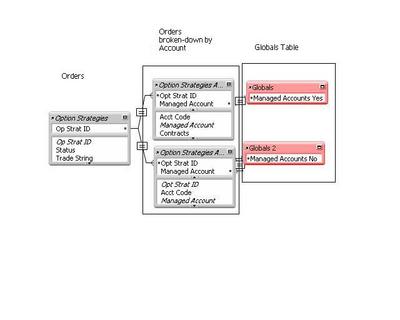

I see where the confusion is.
The Orders Table is a separate table from the Orders by Account Table. The Orders by Acccount is what I am trying to use in the separate portals, just filtered differently.
I hope that is clearer.
