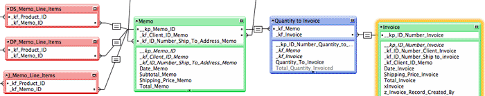

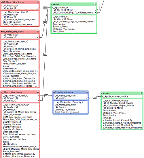

I have narrowed down the problem to what I think is a due to a circular relationship.
I need a way to connect the three different line item tables to the one invoice.
Right now I have to create an invoice table occurance in order to get them linked over to the invoice. This is a problem because I can either display information from the DP and DS line items or the the J line items but not all three on the same invoice. After I have this figured out how to get the three onto one invoice I will be adding one more type of line item.
The set up on the invoice is that I have three portals. One for each product type which are from the three line item table.
Here is my question.... How do I get all three to relate to one invoice table with this (what I think is) a circular relationship?
I have tried many combinations and reworking of relationships.
I think the problem is that they all relate to the memo ( which is a consigment type of invoice ) and this creates the circular relationship.
Thanks for any input!
Frustrated... uhh I mean Drew_S
It's impossible to create a circular reference in FileMaker 7 or later. I looked at your relationship diagram and all you have to do is relate the Invoice TO to the three line item TOs. However, your relationship diagram is difficult to understand. In a typical invoicing solution, you have Invoices related to line items and line items related to Products. I see a Quantity to Invoice TO between Invoices and Line Items and then your other line items related through a Memo table. I've read through the thread again and I don't understand what you are trying to accomplish. I fear this may be too complex to handle through message boards and may require you to talk to someone over the phone.
BTW, you might want to consider storing all the line items values in a single table and differentiating them by a category field.
I originally had the three line items directly related to the invoice as you suggested. This worked perfect. Recently it was decided (not by me and contrary to original design) that some items (those on J_memo_line_items) may be sold in quantity unlike those in the other two (DP and DS) that are unique. It was this request that brought about the Quantity to Invoice Table and my current problem.
Since filemaker prevents circular references the following happens. When I try to relate DP line items to the invoice a second table occurrence ( Invoice 2 ) is created. I can relate DS line items to this second table occurrence. The problem with this is that in layout setup for invoice I have to choose either Invoice or Invoice 2 as the table the layout it based on. Due to this it will display those items on the J table and not the ones from DS and DP (memo line items) or visa versa if I base the layout on Invoice 2. What I ( think I )need is a way to relate all three to just the Invoice table and get rid of the other table occurrences ( Invoice 2). I however cannot figure out a way to do this without have the problem of multiple table occurrences preventing the relationship needed.

I figured out how to make the relationship work.
Since all three line items relate to the memo correctly and each item must go to a memo before to an invoice I just joined from the memo to the invoice with the quantity to invoice join table in the middle. It seems to be working great. All I have to do now is rework a few scripts and the solution should work. If not... I am sure I will be back :P
