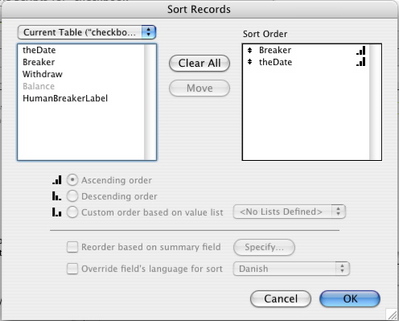

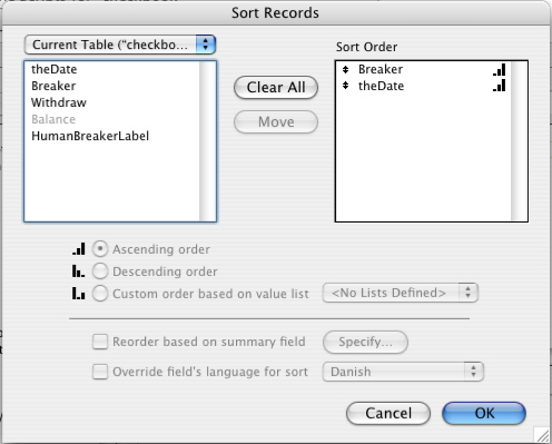

It's pretty straight forward, just stack a list of sortorders, if you switch their order will you get diffferent results - a hierarchy is working!
You might examine my template, or just go ahead with your own!
