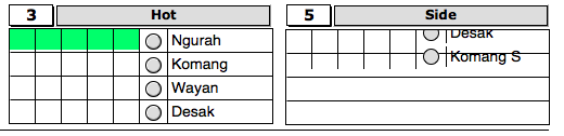

I have a list of records and also 2 portals for this record in the list view.
well everything works well in brows mode. In preview and print the fields from one portal are misaligned.
playing with the field size, moving them, add them one by one makes it print ok.
But I never manage to put all field and buttons before this effect shows
Please what is the problem :?

I must a little restate.
No problem with the list in browse mode. Only preview & printing shows the misaligned fields in either the left or right portal.
Each portal shows only 2 fields (container & text) on top of the container are 5 each buttons (invisible and 1 each beside) ( that should be 12 not 10 ;-( ).
Removing any from that 12 buttons out of one portal( no printing/sliding at all !) cures the problem.
NEW : Taking any other field out of one portal also cures the problem

But I have news .
First I guest that I can make a sample by deleting all the other staff out of a copy of my big file - worked.
Ok and than I looked at KitchenStation1 layout still bad.
The old KitchenStation layout looked fine, but I had this layout without buttons when I made the copy.
I made all the 12 buttons new and it worked with no problem.!?
I than copied this new buttons from the sample file back to my full working file and also here it worked.
So whatever it was something funny to say the least. As a little proof that I was not dreaming I enclosed the sample file .
look at the Station layout .btw to get the pop-up list to :auto populate the Staff records You need Zipp script plug in.

Hey Ohgo_Ohgo!
That seems to work! The "KitchenStation1" layout in preview mode clearly has a problem displaying properly. But KitchenStation looks very nice!
