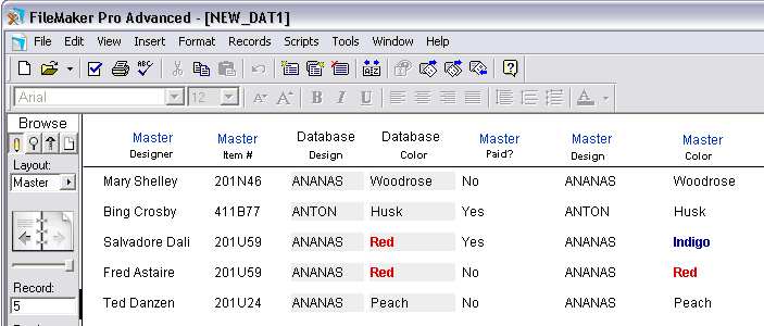

Hi Aldipalo,
I'm having difficulty with this auto entry issue. In the Master Table I have set the design and Color fields to auto enter data from the design and color fields in the Database Table. "Do not replace existing value" is unticked.
When I select the master item number from your drop down, everything works fine. The design and color fields in the Master Table are updated with the values from the Database Table.
But if I manually overwrite a color in the Database Table, the color in the Master Table does not change.
You can see on my screenshot that the color for item 201U59 in the Database Table has been changed to red, yet the color in the Master Table remains as Indigo. In the next Master record I used the drop down to select the 201U59 item, and the Color correctly changed to red.
I'm having the a similar problem in my own database where the auto update works on some records but not on others and I cannot figure out why. This is a big problem for me as I wish to use some of these auto entered fields in relationships.
