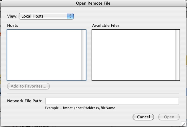

We have 5 Macs, one running FMP 8.0 Advanced, the other 4 running FMP 8.0. One database file is on the computer with 8.0 Advanced. I have turned Network Sharing On for All Users. Don't display in Open Remote is NOT checked. I open the file on the host computer. On another computer, I can see the host computer, but no files.

FileMaker Pro files should not be shared using the OS level file sharing. They have their own internal peer to peer sharing ability.

Now the user who host a file, have two choises to open a file 1) doubleclicking at it or... 2) open it from filemaker via the file menu. The other users should not be able to see any files not residing on their own machine - all access to shared files should be made by turning sharing on for the desired files INSIDE Filemaker.
Remote users should access the served files via the open remote - see image above. Just as you use http:// to deal with the current website and not have mounted the harddrive it's stored on.
Now because the owner of the file by his/her operatingsystem is allowed to open by double clicking, can remote user do the same BUT shouldn't due to concurrency descriped above - it's one more sure recipees to make file corruption to hit your system in a hurry.
