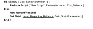

it seems a very easy task for FM7, using a variable to store the End_Balance before to create a new record.
So all you need is a script to make a new record with these steps:
Set variable[$storeEB = YourDB::End_Balance]
New record/request
Set field [YourDB::Beginning_Balance ; $storeEB]
Daniele, when was $variables introduced??? With fm8 in my humble opinion! The way we dealt with it back then, was to make the script recurse, to avoid buttons with the scriptparamter tied to it ...look above!
