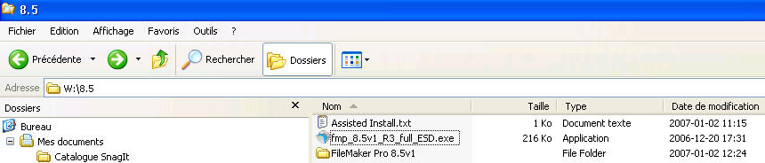

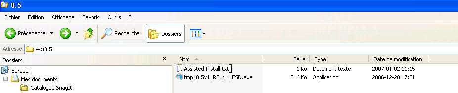

My problem, from the download I got from Filemaker, the only file I got that is an .exe is: fmp_8.5v1_R3_full_ESD.exe no sight of in my Setup.exe
Can anyone guide me on how to find the "other required installation files( I found the assisted install.txt file)"

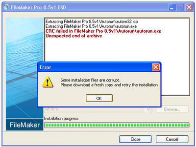

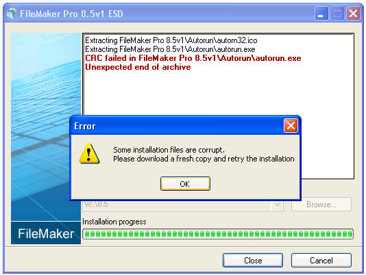

Here is what happens:
Extracting Filemaker Por 8.5 v1 autorun32.ico
Exracting Filemaker Pro 8.5 v1 autorun.exe
crc failed inflating Filemaker 8.5 v1 Autorun.exe
Unexpected end of archive
error
Some installation file are corrupted
please download a fresh copy an retry
I'm pretty safe my copy is not corrupted as I did a direct install with no problem on other stations.
What do you think?
Luc
I think you're going to have to do another download. Also maybe contact Tech Support.

I'll contact filemaker support. Meanwhile, here is the file and screen captures of what happens when I run the .exe.
Luc

Hi again,
here are two more screen captures ( in my previous post, I reached the limit of attachments).
Luc

It was indeed a corrupted file that caused the issue. However, I must mention, in case other people have this issue, that the "setup.exe" is in the File Folder which in turn is in the Filemaker Pro 8.5v1 folder that is created when the downloaded file is expanded.
Hope this will help others.
