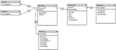

...but the problem is to define which is the subset of which, because some quotations will never turn invoice, so perhaps a Activity table is from where both invoice and quotations inherit the informations from?

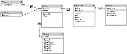

I couldn't help being slightly inspired by Corns blog, so I set out to see what takes of scripting to shift wagonloads (pages of itemlines) of data from one apparent table to another utilizing the tunneling of data, when it is so that we would hate two locations for the same data if posible at all.
The above graph is tied together non achor bouy'ish because it better illustates some of the points. But as the various "Allow creation of related..." is et up, does it all boil down to following scriptsteps:
If [ Get ( LayoutNumber ) = 1 ]
     Set Field [ Invoice::InvoiceDate; Get ( CurrentDate ) ]
End If
Where the condition is that the script only should work in the quotation layout, and force thru the creation of the invoice with the same content, but with it's own date and invoice number.
What I never ever have given a thought until now is the posibility to turn "Allow creation..." on in both sides of a relational connection.
As a kind unexpected yield here is if the storage senses a invoice exists over the many to many relation will it be abel to adjust storage levels accordingly, while the linkings with only a quote is the storagelevel that still is "optional"!
