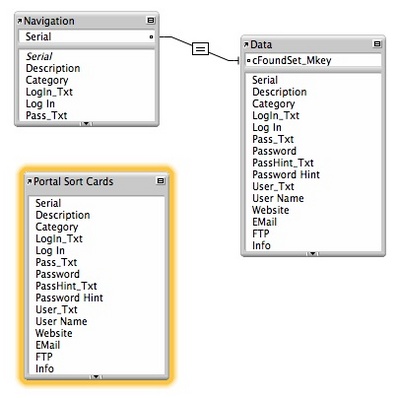

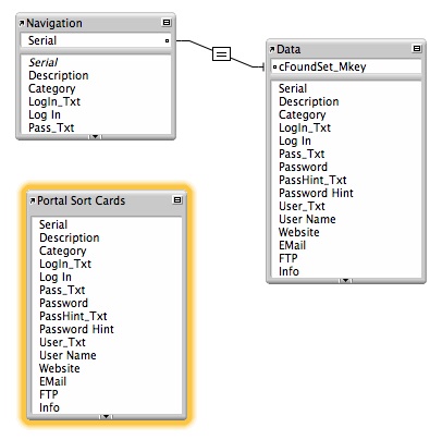

if you want to see different found sets, you need to place different portals ( with different relationship ) into each TAB
How do I connect the portals? Do I duplicate the portal? But how do I use the same data?
Thomas
Four fields:
1) gPwd = global calculation field, result number, and calc: 1
2) cPwd = calculation field, result number, and calc: not IsEmpty (Password)
3) gRmd = global calculation field, result number, and calc: 1
4) cRmd = calculation field, result number, and calc: not IsEmpty (Reminder)
Next steps:
1) relatioship from Main::gPwd and Main2::cPwd
2) relatioship from Main::gRmd and Main3::cRmd
Next steps:
1) place into first TAB ( Passwords ) a portal that shows records of Main2
2) place into second TAB ( Reminders ) a portal that shows records of Main3
I assume like this??

Yes, you assume right !
And you can have all the relationships that you need without any problem. :
