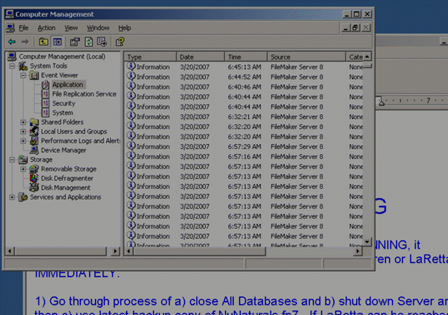

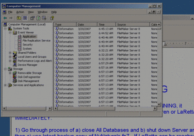

Checking the logs when it happened, I have:
6:57 Server starting (all files opened fine)
6:32AM User A opened from 192.168.0.6 opening Business.fp7
6:32 AM User B opened from 192.168.0.3. This is an off-site User (the Owner)
... [color:red]6:32? It was 6:57 and the computer shows the correct time.
If you look at the error log, the times are out of sequence. These logs have never been out of time sequence before! And I am clueless.

Working locally? We don't work on the Server box. It just happened again. Two Users were on and a third tried to log in. It said it couldn't find the file. I accessed it via GoToMyPC and unserved it. In Events, it says it closed each set of 9 files TWICE. TWICE? There is no file sharing on it. So it had loaded 16 files?
