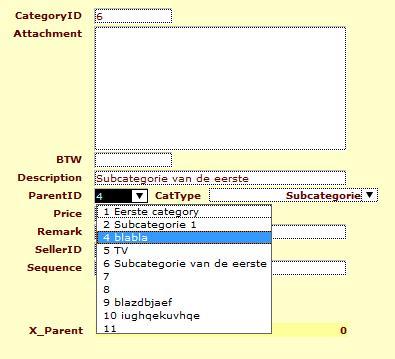

In parentID I want a value list that displays only the category's that are marked 'main category'.
For example (screenshot):
The drop-down list should only display category's where CatType = mainCategory
It's probably pretty simple..
You can have a global field on your parent side that stores the word "mainCategory" and use that as a key to the child Category field.
