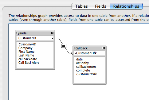

Building a very simple call back system and having a bit of trouble trying to find the records that meet the check, todays date with a N call back complete flag. What I have is this:
Table one:
Company (txt field)
First Name (txt field)
Last Name (txt field)
Table two:
call back date (date field)
call back by (txt field with drop list)
call back notes (txt field)
call back comp (txt field with drop down two option Y/N)

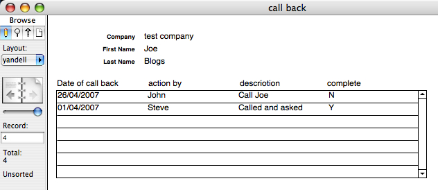

In the main table layout I simply have the "company, first and last name" then a "portal" that shows me the four field from table 2, this is sorted by the date (newest first)
I have set up the tables and relationshsip with ID keys and it shows me a history in the portal of call back dates, notes, who made it and if the call back has been completed with a Y/N reply.
In the portal I have set up a drop down calender and it all seems to work all work fine.
See the image below, as yet I have not design anything yet until I can get the thing to report (so ignore the simple look for now)

You can get started by creating a calculation field in table 2, result text with the option 'do not store calc' checked and with the following calculation
Case(Get(CurrentDate)-call back date>-1 and call back comp ="N";"X";"")
This field will then contain an 'X' when the call back date is today or earlier and call back comp = 'n'.
You can do a find on this field or set up a relationship to it to determine if any records require attention
Hope that gets you started
Phil
Thank you, I got it to put an "X" into that field so it works in terms of the calculation. But it does not put in an "N" but as I only need to find the vaule "X" that does not matter.
The problem I have now is I cant get it to find, what I would like it to do is I can create another layout and on that have a "portal" that lists only the entry that have the X in them. Can you give me some pointer how to do this.
Just got myself "FileMaker Pro 8 the missing manual" but not finding many answers.... yet.
