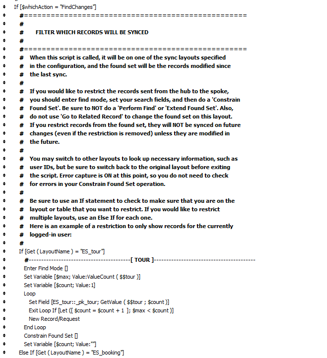

We have been trying to amend the MirrorSync Customisation script and have been failing to get the necessary results
The premise is that currently the sync needs to go one way - from the HUB to the SPOKE
The filter needs to be applied to each of the tables that we need to sync records for and that filter is contained in a $$tour variable
This variable has one or more values in it as a list and we extract each value and create a find request for it and then constrain the found set
This process is followed for each of the tables as part of a large 'If - Else If - End If' which tests for the layout name and runs the find - see the screenshot of part the script amendment attached as the construct shown is simply replicated further in the script
Are we doing anything stupidly wrong here ?

You can't use $$doubleDollar global variables in the script, because it's running server-side with no user session.
This is documented in the comments in the customization script about one inch higher than the top edge of your screen shot.
The solution is to do whatever find you need to populate the variable, instead of relying on the global variable being already set when the script is run.

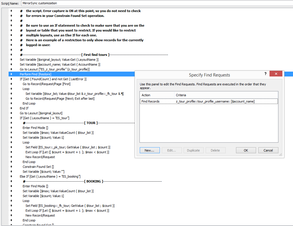

Hi Jesse,
I am working with Harry on the same project - thank you for your help so far. Unfortunately, we are still having problems.
As suggested, I have changed our code to set a local variable within the customisation script in order to filter the records we would like to sync. I have done this by using the account name the user has logged in with to find our list of keys.
In the testing I have been conducting, I log in with account name 'stairslewis' in both the spoke and hub. Using the find request in the image attached, the $tour_list variable would contain only '925' (though, in theory, could be a return-delimited list of numbers). The script should then go through the rest of the tables to filter the _fk_tour field on this value of 925.
While debugging the customisation script, I noticed that the 'Set Field []' script step is failing (i.e. the field is left blank) but there is no FileMaker error coming back from this script step. This is the same for all layouts, and the field is set to allow entry in Find Mode. I have tried creating a new script with only the 'Enter Find Mode []', 'Set Field []' and 'Constrain Found Set []' script steps in and the field is set correctly and the constrain works?!
Using the script above, the spoke still synchronises all records at the hub file - with the exception of 1 table. Our 'attachment' table does not receive all records at the hub, but I think this may be due to the fact it has a multi-line key - are multi-line keys a problem for MirrorSync?
Any more help you can give us would be greatly appreciated.

Hi Lewis - the problem is not immediately evident from the screenshot. We could work on troubleshooting this if you want to send us a copy of the file and an export of your MirrorSync configuration, but since this is related to customization, we would need to bill for our time ($165/hour). If it turns out to be due to a bug in MirrorSync (I don't think that's likely based on the type of trouble you're having), there would be no charge.
I did notice a few things that I wanted to point out:
* It might hurt sync speed to do the find and set $tour_list on every call to the MirrorSync customization script. This script gets called fairly often, so it's a good idea to only do time consuming operations inside an if statement dependent on the relevant layout.
* I would restructure your loops so that the exit loop check happens before the set field. This is a general best practice; currently your script will do unexpected things if the $tour_list variable is empty (I suspect that may be happening); by first comparing $count and $max before setting the field that will help avoid that.
