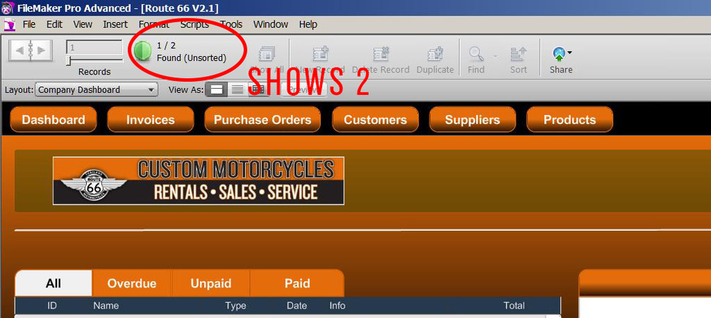

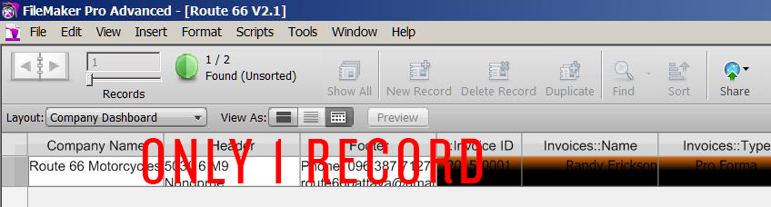

The problem is that when I imported the Company Dashboard, It seems to have created a phantom record that I can't delete. As you can see from the atached screenshots, the found records show 2 but in table view only one shows and all the buttons having to do with record keeping are greyed out and no Records button menu.
Any Ideas?

Unfortunately none of the record buttons function. They are all greyed out no matter what mode I am in so the show all button has no effect. They work with all other layouts.
No matter what i try I cannot delete the second record.
Any other suggestions?
Maybe permissions to delete are restricted for this table?
Don't Know what the problem was but I found the solution.
I created a new layout in table view using Company Dashboard as the source.
I opened this layout and all the record buttons worked. I was then able to delete the offending record and all is well in Whoville...
