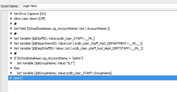

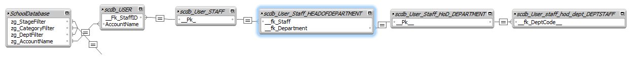

I've got the attached script which takes the users account name and and then based on the relationshihps returns their staffID, DeptID and then a list of staff members in that dept.
This code brings back all employees in that staff table related to that department, irrespective of whether they are Active or Leaver.
How do I amend this script / relationship to return only Active members of staff?

You could add another relationship that uses a constant to constrain the related set, but the easiest solution is probably to create a calculation field = Case ( status = "Active" ; ID ) and List() that.
Or look into creating a query via ExecuteSQL().

In answer, the reason for this is the Heads of dept can only see the staff members attached to that department. From the home layout, they click on a staff button which takes them to the staff list layout displaying only those staff members in the department. The script is doing this perfectly for me.
However, at the moment it is also showing Leavers as well as Active staff members in this list and I don't want it to.
Eos I have got that constant field already set up in my School Database table  (zg_Constant_Active) but I'm struggling to figure out how to add it into the relationship i've created.
Any help is greatly appreciated.
