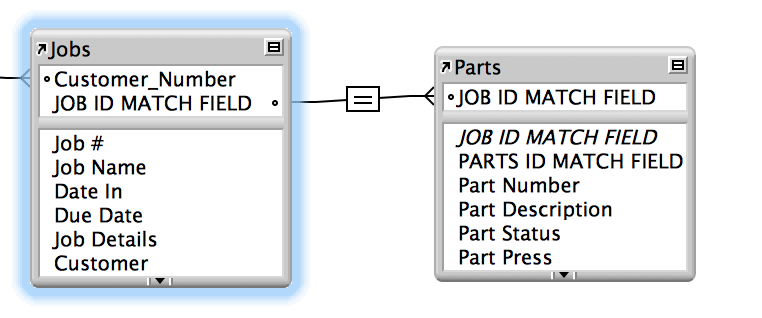

We have two tables.. Job and Part
The Job table we have a layout that has a portal for the Part Table. We are keying of "JOB ID MATCH FIELD"
We have a layout that on Job to show us the related Parts. Each part has a status... "In Progress" Or "Complete"

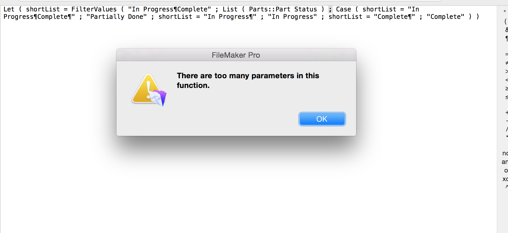

Try =
Let (
shortList = FilterValues ( "In Progress¶Complete" ; List ( Part::Status ) )
Case (
shortList = "In Progress¶Complete¶" ; "Partially Done" ;
shortList = "In Progress¶" ; "In Progress" ;
shortList = "Complete¶" ; "Complete"
I'm getting an error about to many Parameters Error.. See screen shot.
That's not what I wrote.
Your right.. I changed the Part::Status to read Parts::Part Status.
Other then that I did a copy and past.
This time I did a copy and past to and editor then copy and pasted it to filemaker.. No errors.
But it's not returning anything for the calc.
Question? How does the formula tie to the Relationship?
​Does this work for you?
Status.fp7
Your file worked... So I went back to my file and found the reason.
I had an extra space at the end of the data....
Thanks so much...
