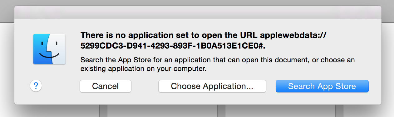

Getting closer. Most of the plugins seem to install and I get to the main DocuBin browser window.
Whenever I click on any of the Library items I get an error (see screen grab). In the FileMaker Pro prefs the Docubin Companion Plugin is inactive. Trying to activate it causes an error. Quit FM, manually removed the plugin from the extensions folder. Do not get prompted that the plugin needs to be installed.
