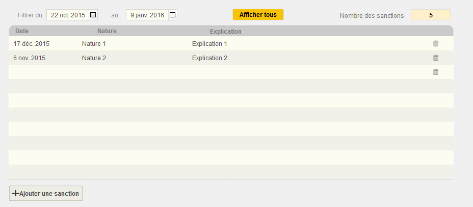

Hello everyone,
I have two questions:
1/ How to display all  records of a TO after filter;
2/ How to update the field Number of sanctions according to the filter dates.
Thank you

Are you using a portal filter or a filter on the TO itself?
If you're creating a portal filter and want to show all records, you can use an IF statement within a let like this(you will need to adjust the variables and fields):
Let(
dateStart = if(isempty($startDate)=1;date(1;1;1901);$startDate);
dateEnd = if(ismpty($EndDate)=1;date(12;31;2900);$endDate)
dateField >= dateStart And dateField<=dateEnd;
You can add your sanctions filter logic into this Let statement as well
Edited by GisMo
That's a very confusing question. If you have a filter, then why - or under what conditions -  do you want to display all records?
If that field is a summary field, defined in the child table, place it in a one-row portal to the same TO and with the same filter as your existing portal.
Filemaker can handle dates in the range from Jan 1, 0001 to Dec 31, 4000.
