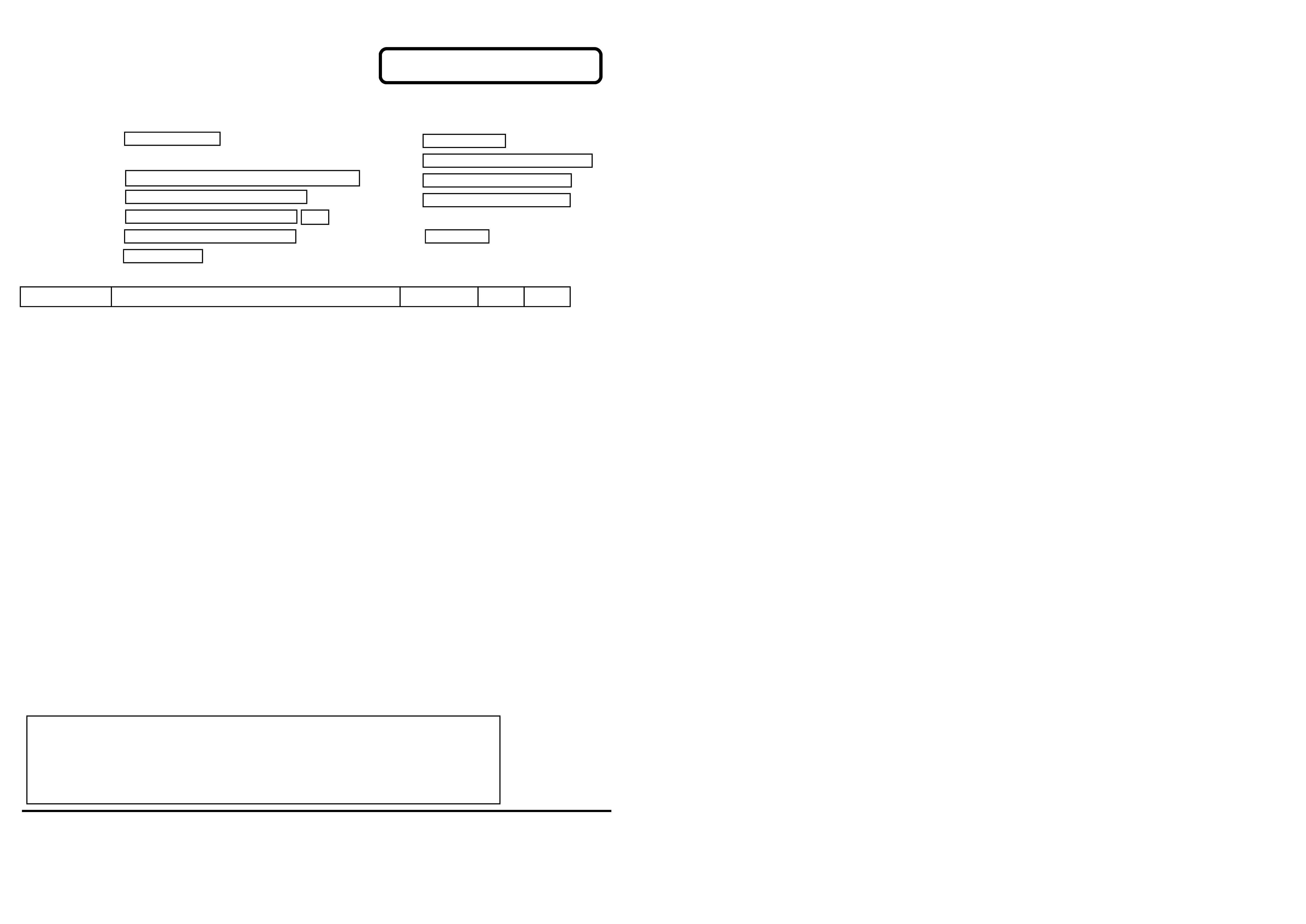

A client of mine has installed a 32bit FM14v4 client on a 64bit Win7. Now when I do : save as Pdf the pdf turns up with empty fields.
Does anyone else have this problem ?

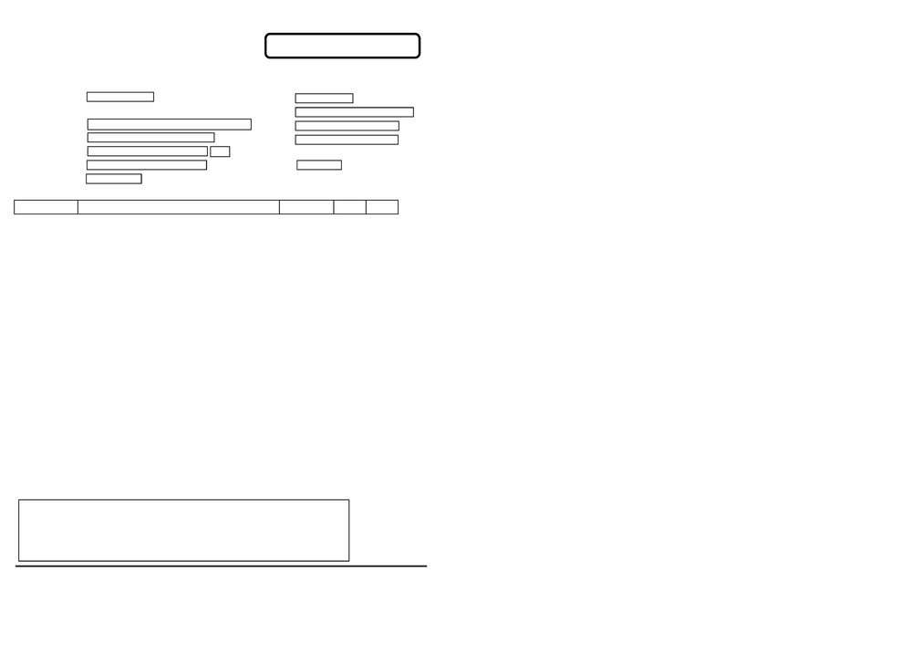

They do not seem to have any Acrobat products installed en they do have FM14v ( 32bit ). Problem does not seem to occur with 64bit.
However, I noticed one part being printed ( I removed it from the screenshot as it contained sensitive info ).
Looking further into this I noticed that this static text part had Arial as the font. The other parts all had 'Helvetica'.
After going thorough every label/field and changing the font to Arial, the report resumed printing as normal.
Very strange...
