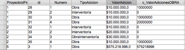

I need some help with a little problem that I have found repeatedly. I attach one image of one of the cases
In the first table, I have a ProyectoIdFk (Proyecto Foreign key, to relate the values in this table to another one, the projects table), an Id field which is a unique number for each row (or specifically, an addition. A value added to the initial value of the project),  TipoAdicion (Addition Type) that could be either Obra (Construction) or Interventoría (Oversight), ValorAdicion with the value of each addition and c_ValorAdicionesOBRA (Calculation field to add up all the additions defined as Obra) which isn't working properly yet and therefore I need your help.
5695badff15f6_Capturadepantalla2016-01-1

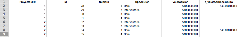

I would like to know how to sum, for each ProyectoIdFk the additions' values marked as "Obra" as shown in the table below I made in Excel to make understanding easier.
.Result_wanted.png.7e3b169f3a28c474a17b16
For ProyectoIdFk = 1 (Repeated 4 times because the project has 4 additions) , I'd like the field c_ValorAdicionesOBRA sums the 3 additions defined as Obra to get a total of 40'000.000. The same for ProyectoIdFk = 2.
My intuition says I should include the c_ValorAdicionesOBRA in the projects table (so it can be related to each project), but when I do this, it keeps adding up every addition (Obra + Interventoria) and I just want the Obra ones. I guess I'm trying to mimic the sum.if from Excel but I already realized FM works differently... :/

The simple solution would be to find only items whose type is "Obra", sort them by ProyectoIdFk, and place a summary field defined as Total of [ ValorAdicion ] in a sub-summary (when sorted by ProyectoIdFk) part.
If you want to keep the other types in the found set, you will need to also sort by TipoAdicion and add a corresponding sub-summary part. If you like, you can use conditional formatting to "hide" the other sub-summary values.
There is no SUMIF() function in Filemaker, and to mimic it perfectly you would have to add both a calculation field = If ( TipoAdicion = "Obra" ; ValorAdicion ) and a summary field to total it - which IMHO is too much effort for the expected return.
