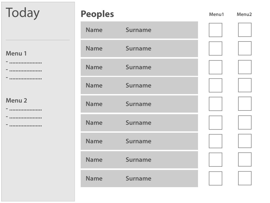

i'm new to filemaker and programming too. I need to create a layout that allow me to enter daily people's choice between two menus: Menu 1 and Menu 2.
I create a people's table, menu tables and a join table peoples_menu.
It should be something like this (see attachment)
How can I grab the choice?

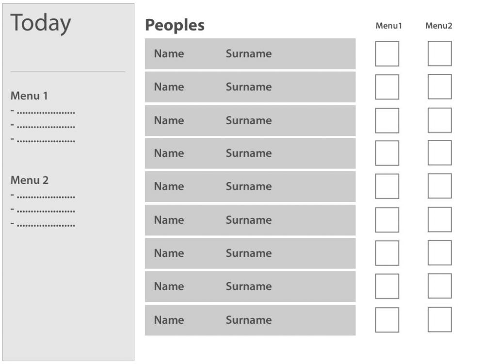

It's possible with filemaker to make a layout like the previous attachment and if yes, on what table?
Themusic
You would have to use a portal to the Peoples table, based on a relationship using the x relational operator.  This could be from any table - perhaps you'd prefer to create a utility table for this.
