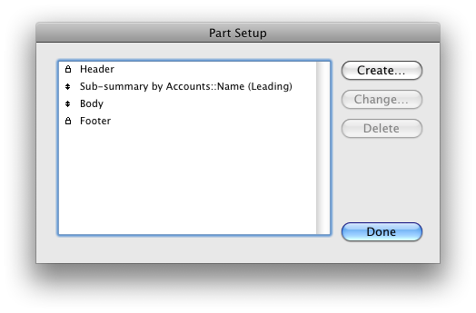

Ok, then this should be quite simple. Your layout (based on the Projects table) needs to have these parts:
parts.png.a97e4106b4abe6425b2a40a8400358
  • The Header and Footer parts are optional and need not contain any fields;
  • Place the Project Name and Project Value fields in the Body part;
  • Place the Account Name field (and any other fields from the Accounts table you want), along with a summary field (defined in the Projects table) that totals the project value field in the Sub-summary part.
Now you just need to go to this layout, find the projects you want to include in your report and sort them by Accounts::Account Name and (optionally) by Projects::Project Name (all this can and should be scripted).
