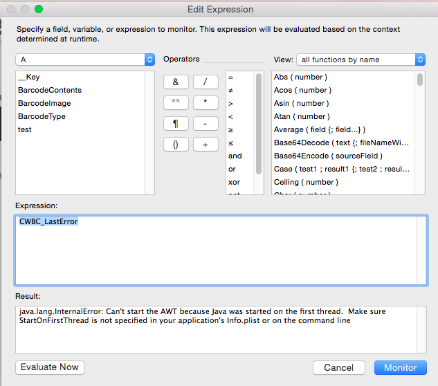

On Mac OS X 10.10 and 10.11 in FileMaker Pro Advanced 14 the compiled plugin works only every 2nd time when I uncheck and check the plugin again in FileMaker > Preferences... > Plugins, Enabled plug-ins. When the plugin does not work (ERROR is returned), if I check and uncheck in Preferences in FileMaker, I get the message "'?' failed to initialize". When the plugin does not work, the error returned by the 'LastError' function is this: java.lang.InternalError. Can't start the AWT because Java was started on the first thread." I have tested this on multiple machines , also machines that did not have the ScriptMaster plugin itself installed. I removed the Oracle version of Java and installed the Mac version as well.
It looks like an issue with the plugin not managing threads correctly?!

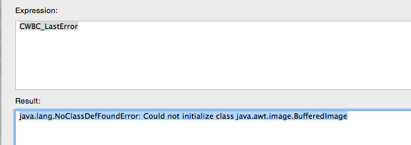

I get this error message as well. Probably this is just a result of the other error.
