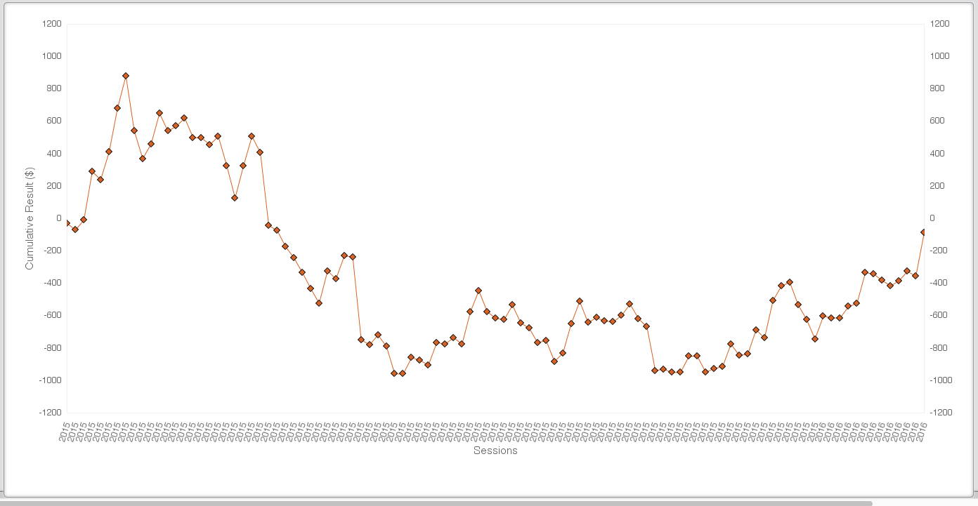

Here's a picture of the chart -- thee X-Axis is just showing the Year, derived from the Date, of each 'Session'.  Instead of having that Year appear for each data point, I'd like it to just appear for the very first Session of each year.  I'm not concerned about the X-Axis having a regularly-scaled timeline (I don't want a big gap if there are no sessions for a 3-month stretch) -- I just want to be able to see the rising and falling of the cumulative total over time.  As you can see here, the X-axis labels get crowded in a hurry, and this is just a grey blur if I look at a chart with a larger set of found Sessions.
Try defining the following fields:
  • SessionID - Number, Auto-enter serial number
  • cYear - Calculation = Year ( Datefield )
  • sMinID - Summary = Minimum of SessionID
Then specify the chart's X axis values as a calculation =
If ( GetSummary ( Sessions::sMinID ; Sessions::cYear ) = Sessions::SessionID ; Sessions::cYear )
Records must be sorted by cYear for this to work. Note that this assumes your chart is not set to show data points for sorted groups.

I meant to get back and thank you for this -- works great!
