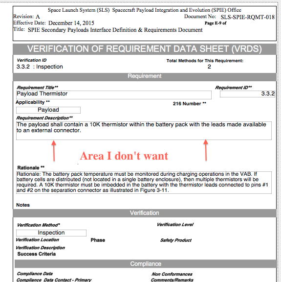

Problem Sliding Up Field in Preview
Below is an example that I am having.
It appears the actual field is sliding up. But there is still white space before the next field.
Thanks.

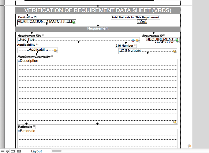

I suggest two things:
1) Make sure none of the objects overlap.  I suspect Rationale is not sliding because it is not completely below Description field.  Select Description and get it's bottom location in Inspector. Then select the Rationale text and make sure the top number is 1 pt below that.  Repeat for the Rationale field, making sure it is 1 pt below the Rationale text.
2) After you've made sure everything does not overlap, drag your cursor around all objects in the body and re-set them to slide up just to make sure there is not a hidden text object or line etc which is causing the failure.  ANY object not set to slide can cause the rest to fail.
There was a hidden object that was causing the problem.
Thank you La Retta.

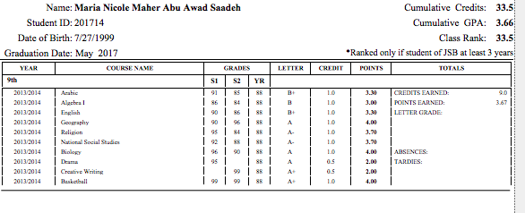

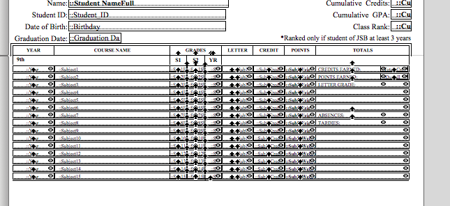

I'm having this same issue but can't seem to find anything. Mine is a tiny gap just below the bottom field. I've done both of your suggestions, but still a tiny gap. Is the gap the hidden fields just not completely hiding?

It is difficult to see but it looks like those fields are more than 1 pt between the subject 'rows'.  Try this:
  1. Back up your file first.
  2. Select the Subject1 field.  Increase it's height by 1pt.
  3. Drag/select around all the fields from the Subject 1 line on down - Grab ALL fields on all the rows.
  4. From Inspector 'position' tab (the ruler), go down to 'Arrange and Align' and to the Resize portion.  Select the fourth icon, which is 'resize to largest height'.  This will crease the height of all the fields by 1 pt.  Then go to browse and take a look.
  5. Lastly, if there is still a small gap, that bottom line looks an additional 1 pt too low so if need be, move it up by 1 pt.
