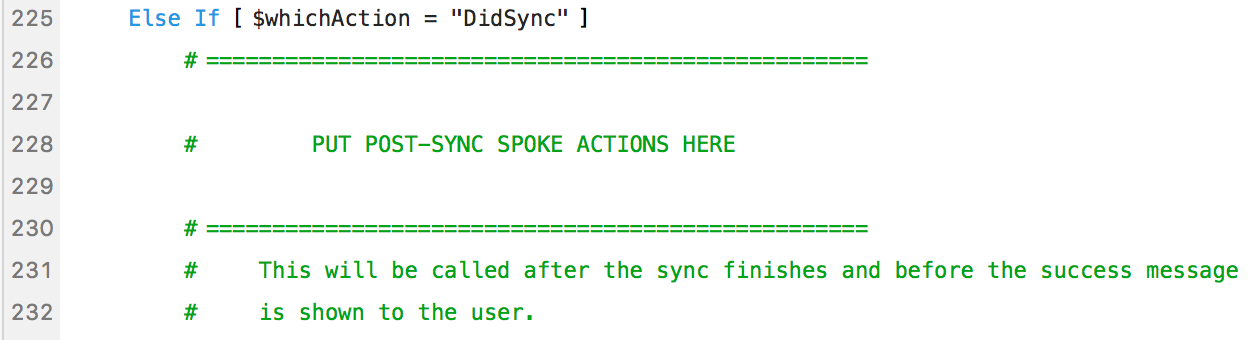

February 18, 201610 yr Newbies I'm sure this is covered somewhere but my search didn't turn anything up. Is there a flag in MirrorSync that I can use to trigger a script if there is a successful sync? I believe I saw this somewhere but can't locate it. In particular I'm looking to trigger a script on FM Go. Thanks!
February 18, 201610 yr Not really a flag, but our "MirrorSync customization" script will allow you to do this. In the customization script you have actions performed on the hub and actions performed on the spoke. In this instance you want actions performed on the spoke, so look for "Else If [ $whichDatabase = "Spoke" ]", now look for the actions - scroll down and find "Else If [ $whichAction = "DidSync" ]" and you've hit the correct location to trigger your script! Check out my attachment for the exact code you're looking for.
