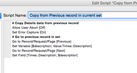

February 22, 201610 yr I'm looking to place a button on a layout whereby it causes a given field to be filled with the value entered in the corresponding field from the previous record. e.g. I'm creating a new record for a client's consult notes, and the 'notes' field for the previous visit(record) need to be carried over to the current entry. This is not always the case, hence I don't want it to be copied over automatically when a new record is created. Hence a "Copy Previous" button will give me the option. Struggling with figuring out the right expression/s to use to build the appropriate script for the button. Any thoughts?
February 23, 201610 yr At it's simplest, the below I'd probably abstract it a bit so I could pass in the required field via ScriptParameter so it could be used for many fields

February 23, 201610 yr 10 hours ago, db_tragic said: the value entered in the corresponding field from the previous record. We need a better definition of "previous record". It could be the previous record in the current found set, using the current sort order - in which case the value is accessible through the GetNthRecord() function, or by going to the previous record (as suggested above) - or it could be the previous record in creation order - in which case you would need a relationship to access it reliably.
February 23, 201610 yr Author 4 minutes ago, comment said: We need a better definition of "previous record". It could be the previous record in the current found set, using the current sort order - in which case the value is accessible through the GetNthRecord() function, or by going to the previous record (as suggested above) - or it could be the previous record in creation order - in which case you would need a relationship to access it reliably. It is the previous record in the current found set, sorted by date (descending).
February 23, 201610 yr 7 minutes ago, db_tragic said: It is the previous record in the current found set Well, then a single-action button, set to: Set Field [ YourTable::Notes ; GetNthRecord ( YourTable::Notes ; Get ( RecordNumber ) - 1 ) should do just fine.
February 24, 201610 yr Author On 23 February 2016 at 8:43 PM, comment said: Well, then a single-action button, set to: Set Field [ YourTable::Notes ; GetNthRecord ( YourTable::Notes ; Get ( RecordNumber ) - 1 ) should do just fine. Thanks for that comment - haven't got round to applying suggested solutions as yet. That does look like a tidy one though, thankyou.
February 25, 201610 yr Author On 23 February 2016 at 8:43 PM, comment said: Well, then a single-action button, set to: Set Field [ YourTable::Notes ; GetNthRecord ( YourTable::Notes ; Get ( RecordNumber ) - 1 ) should do just fine. Worked a treat, Thankyou.
