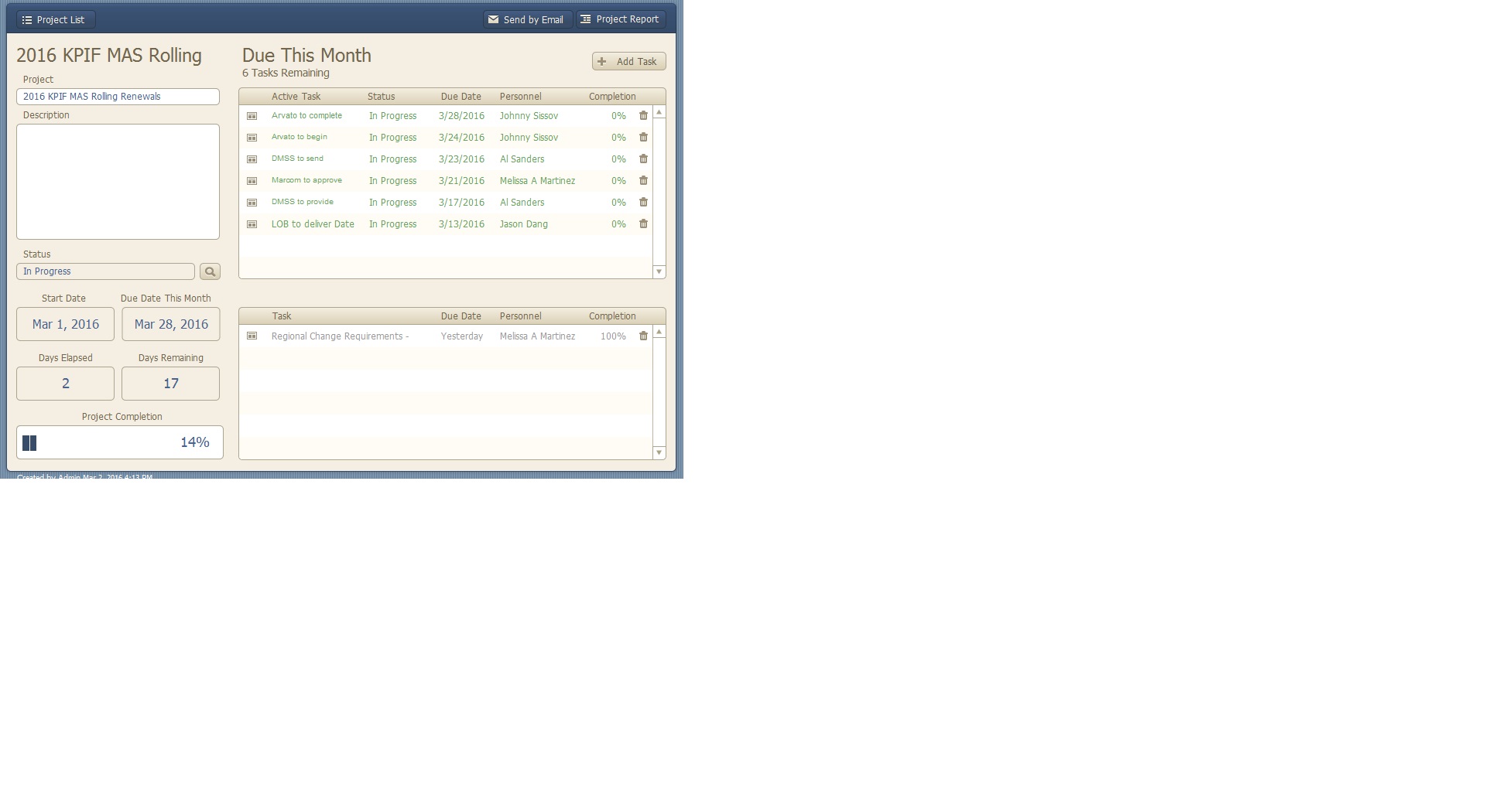

While in project details, I cannot get it to sort by the Due Date.
If I go to the 'Sort' function, and do an ascending sort by verbose due date, it remains in an descending sort.
This is because the Due Dates are in Portal, which looks through to a sub-table.
In Layout mode, double click on the Portal and you should see an option to Sort the Portal - now choose the Due Date from the sub-table.
HTH
i knew the answer was simple, thanks!
