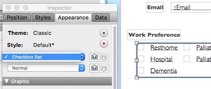

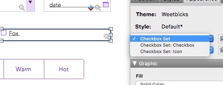

I've been working on a database that was originally created in FM 11 but has been converted to work with FM 14. I went to format a checkbox set the other day, and I don't have any of the additional options that are standard for FM 14 (see screenshots).
I ended up creating the style I wanted in a FM14 database then copying it to the converted one. A bit of a bugger and a little time consuming.
I'm assuming it's due to the conversion since I can't think of anything else. It's been converted for a while (nearly a year) and running fine, but I'm wondering what else could be missing.
Does anyone have any explanation or ideas of fixing?
Classic theme was deprecated in 13, so I suspect it doesn't support the newer Styles in 14... What happens if you change the Theme?
You're a champ mate! Changing the theme opens up the other options. I suppose that means I'm finally going to have to get around to creating a custom theme.
