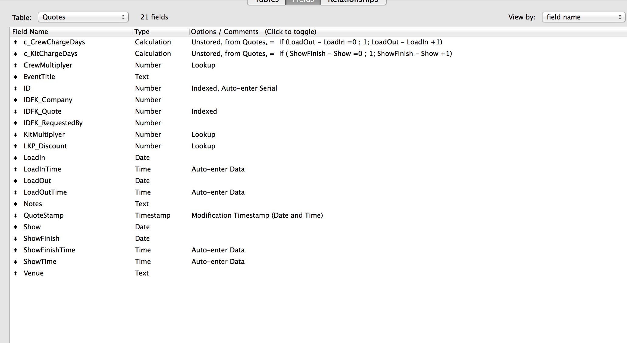

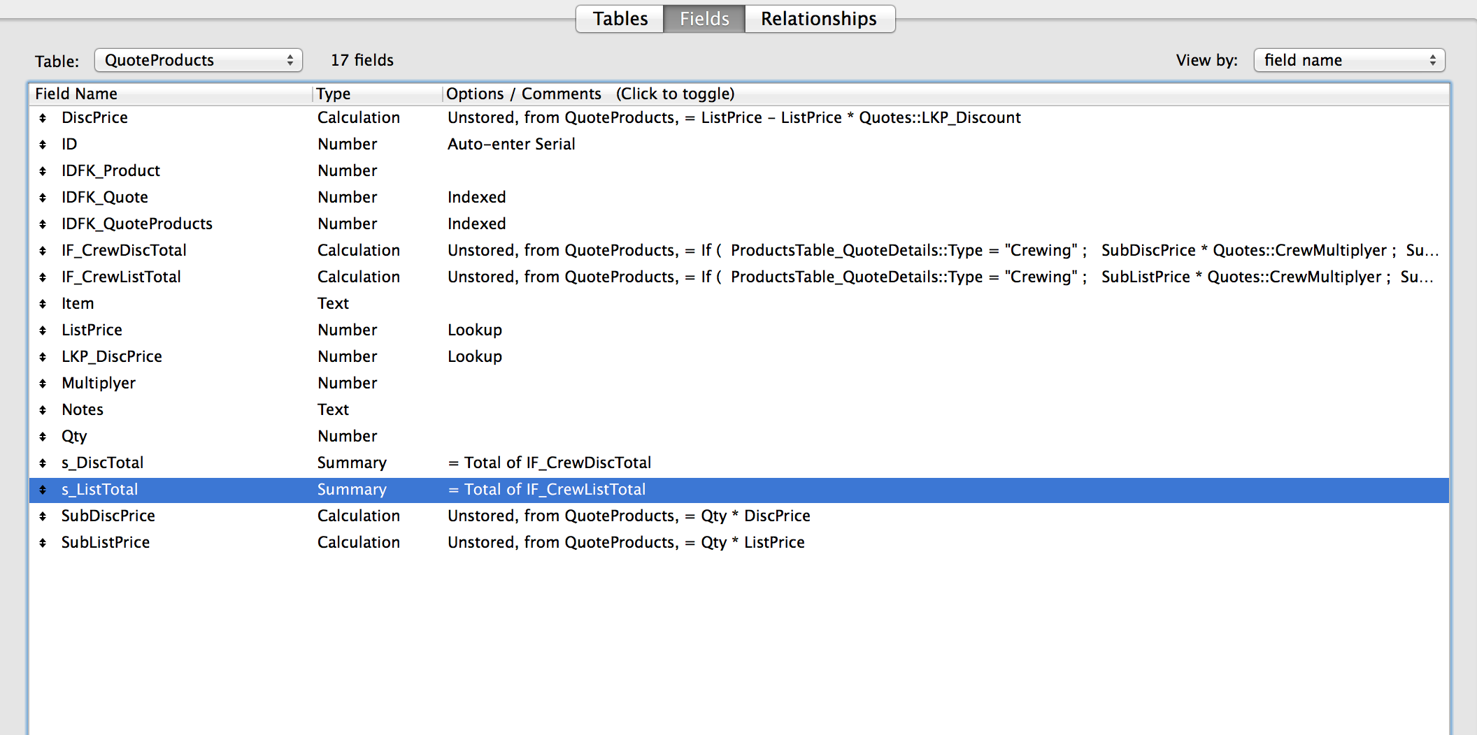

Hi Agnes,
Yes, so here is the calculation for IF Statement:
Quote
If (ProductsTable_QuoteDetails::Type = "Crewing"; SubListPrice * Quotes::CrewMultiplyer; SubListPrice * Quotes::KitMultiplyer)
Then the Summary Field is in the screenshots below.
I should add that QuotesProducts is a Portal inside a Tab on the Quote Layout.

Hi Neil,
I'm so sorry but I'm not sure what you are trying to achieve here. I took a look at your file (you sent me in a private message).
Here are some recommendations for you:
  • When creating invoices I recommend following standards that are out there. And invoice record should be self-explanatory. The same goes for a quote.
  • Your field labels and the field names should match, so you won't get lost when reviewing your solution later.
  • Your QuoteProducts table should be called Quote_Item, just like it should be called Invoice/Invoice_Item. The underscore is not obligatory.
  • What's IDFK? Are you referring to a foreign key? Cause it can't be an ID (primary key) and a foreign key at the same time. I recommend naming your foreign keys either FK__TableYouAreGettingTheIDFrom or ID_RelatedTable.
If you are calculating information from the child table (QuoteProducts) you'll have to create another table occurrence for the Quote table and hook it up to the QuoteItem. I added that in red in your solution.
You can't have an auto-enter on your field entering ALL the values you are trying to choose later on from a radio button from a value list: http://cloud.zerobluetech.com/2i1O3w053d2s
What's Quotes 2 with the same ID?
The calculation is working in my file. Not sure what you mean by "not working".
Here is your file back. Now if you change the kit multiplier, the line items will change.
I recommend rethinking your structure. There are way too many calculations already and it's a small solution.
