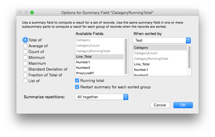

Yes, running totals (and running counts) with restart are the standard sub summary feature I was referring to.
Note that the "1" field is not necessary.
TestMOD4BFR.fmp12.zip
