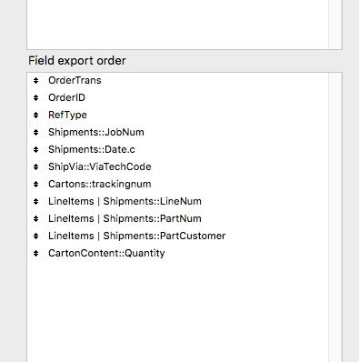

I posted a screen shot of the export to show the tables that I'm grabbing from.

I see that:
  1. you have only one LineDetail per Order;
  2. you have multiple Orders with the same OrderID.
So I think it's safe to say you're not exporting from the parent Orders table.
Oh dang.. I was on the wrong layout when I was exporting..
Thank so much for your help..
