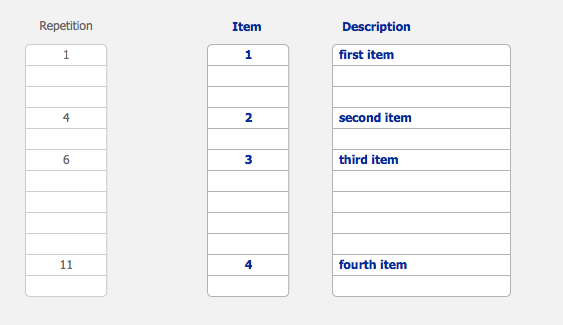

Anyway, here's a method which gives sequential Item numbers which skip any empty entries...
Description  is your Description 'Text' field
Repetition  is an additional repeating Calculation field of type 'Number' defined as:
If ( not IsEmpty ( Description ) ; Get(CalculationRepetitionNumber))
Item  is another repeating Calculation field of type 'Number' defined as:
Let ( [
theList = List (Repetition) ;
thePosition = Position ( theList ; Repetition ; 1 ; 1 ) ;
shortList = Left ( theList ; thePosition ) ] ;
If ( Repetition > 0 ; ValueCount (shortList )))
