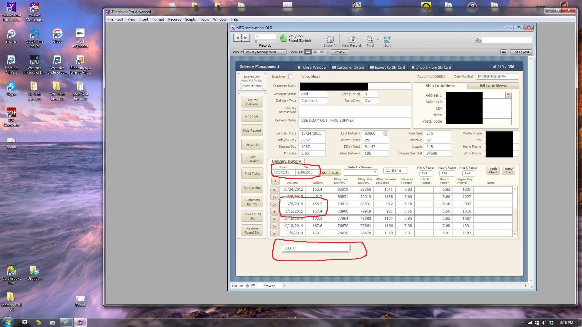

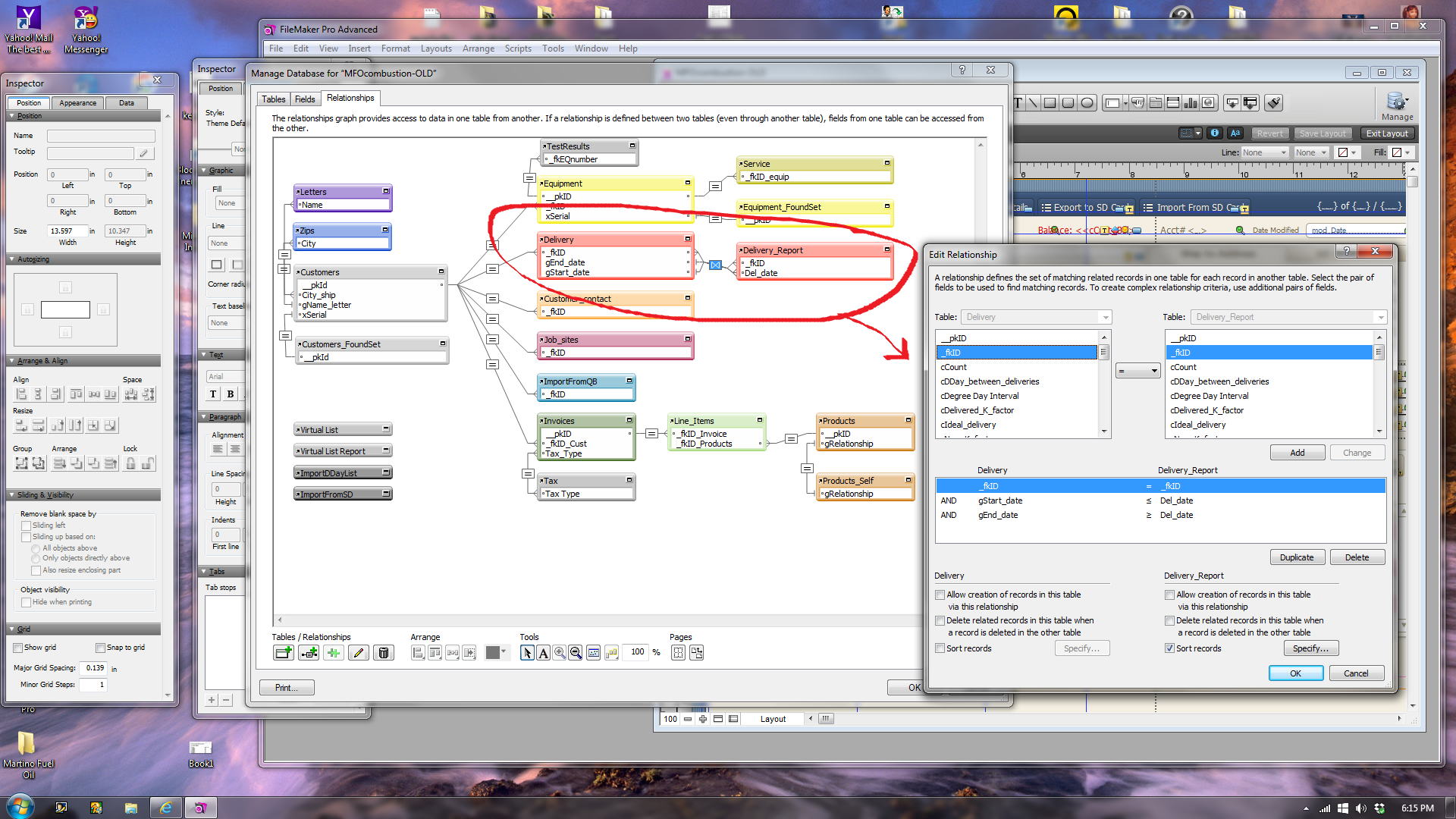

Here's 2 screen shots, one of the graph, and one of the field on the layout

Thanks Steve!! Like I said... very new here but that all sounds like it should get me the info I'm looking for. Thank you also for the visuals. I think I should be able to make that happen!!
