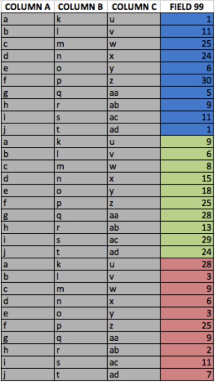

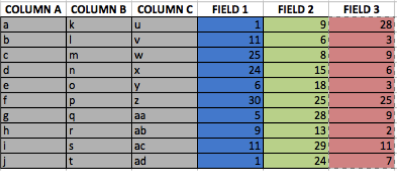

QUESTION : Is it possible to do turn data structured like this;

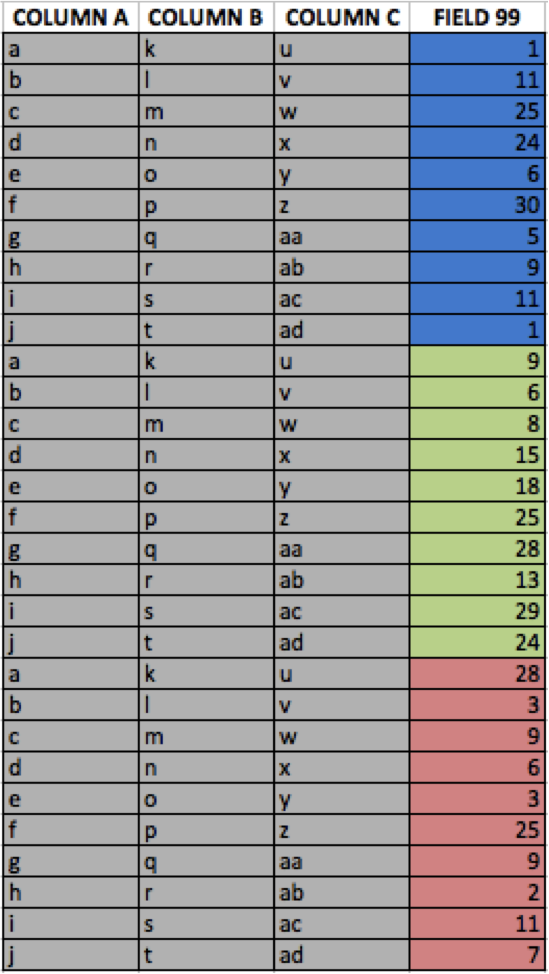

Into this;
Import the source data 3 times. The first time, import the first three columns into their corresponding fields of the target table and FIELD1 into FIELD99. For the second import, keep the same mapping except this time map FIELD2 into FIELD99. The third time, import FIELD3 into FIELD99 - again, together with the first three columns.

I want to get the 3 fields into 1 filed so I can chart them
Not exactly; you also want to get three records for each existing record.
Field 1, Field 2 and Field 3 are months.
I would like to place them in a Stacked Column chart which I cannot do if they are in three different columns.
