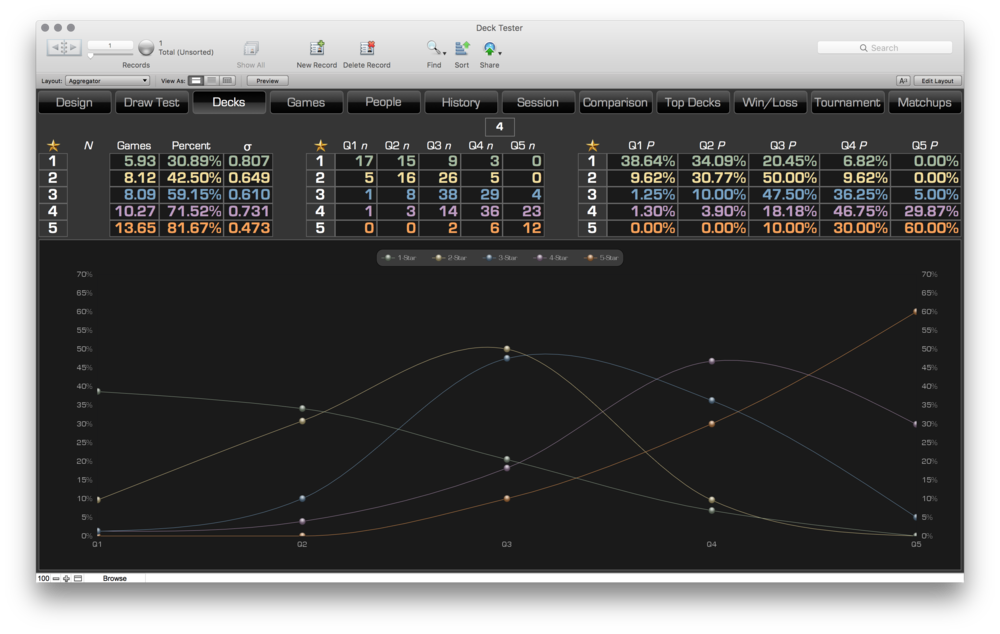

I have a database (admittedly a frivolous one) that tracks my rating (1-5 stars) for Magic decks I have built. It also tracks how decks have performed. In one table, I have created threshold values for five groups, based on games won of those played: those ≤20%, those >20% and ≤40%, those >40% and ≤60%, those >60% and ≤80%, those >80%. I then want to look at the degree of correlation between these two values (star rating and winning percent), which I do based on a minimum number of games played.
First of all, what I have works fine, even when I drop my threshold to one game played and bring up 378 related records. The time to get everything pulled and calculated (the size of each star rating's population, the average number of games played for each population, their average winning percent, the StdDevP of each population as scaled winning percent relates to star rating, the number in each population that falls into each of the five groupings of winning percentages, and the percentage of each group by winning percent), as well as charting that last part is perhaps 1 second, or a hair over. However, I would like to speed this up and simplify the relationship graph as it relates here. This is how it looks now; I build my interface for just my own use, so it doesn't have to be particularly well labeled.

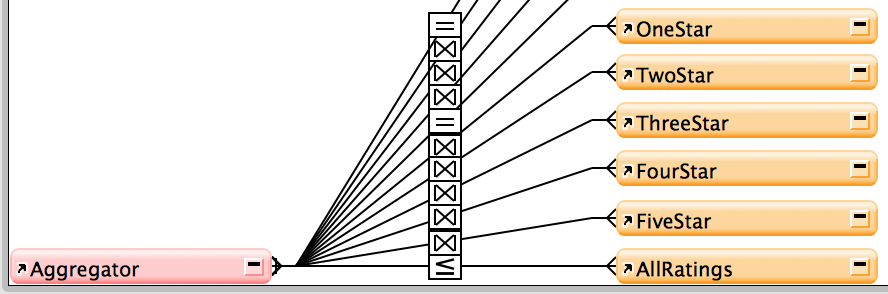

So far, everything is being done with calculation fields, and I am wondering if I am doing things the wrong way. Below is the portion of my relationships graph that relates to these two tables. Global fields in the Aggregator table hold values of 1 through 5. This and the threshold minimum number of games played form the relationships. Each of those relates to one of the TOs that has the data about the percentage of games won by each deck and the star rating of that deck. Each deck has its winning percent checked by five fields, returning a 1 if the value is true for the range conditions set (say, >.4 and ≤.6). Those fields then display across each row in the center grid above. Each row is a relationship, and each column is the same field as it is viewed by the different relationships.
I figure there has GOT to be a smarter way of doing this, but given that this beast has evolved over a period of nearly a decade, I am still finding other efficiencies on old stuff. This part is relatively new, so I am almost certainly doing it poorly.
