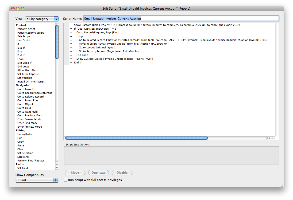

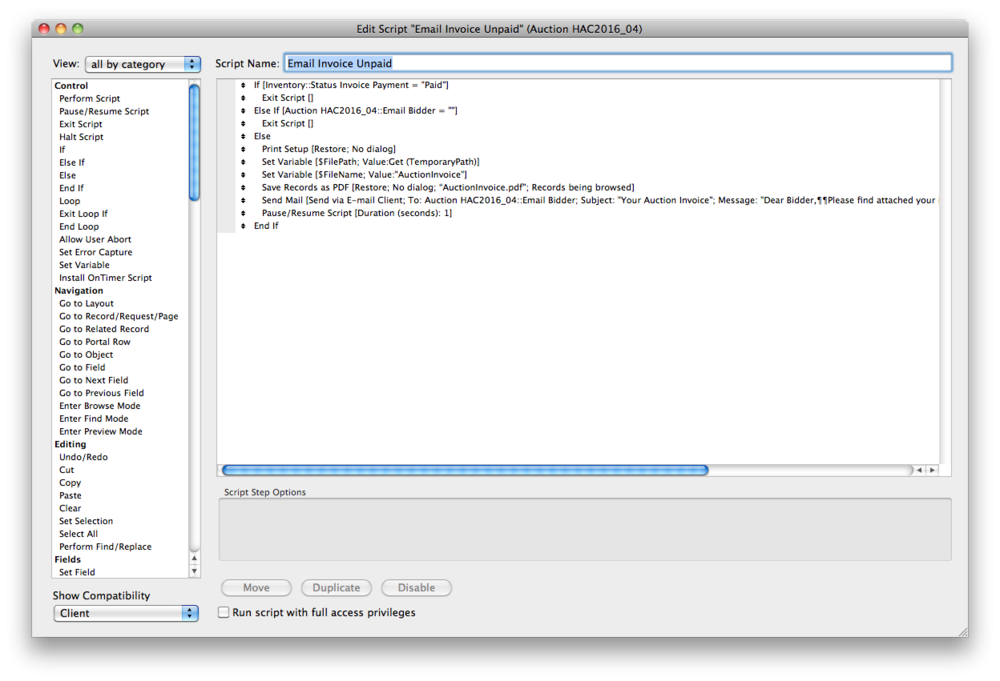

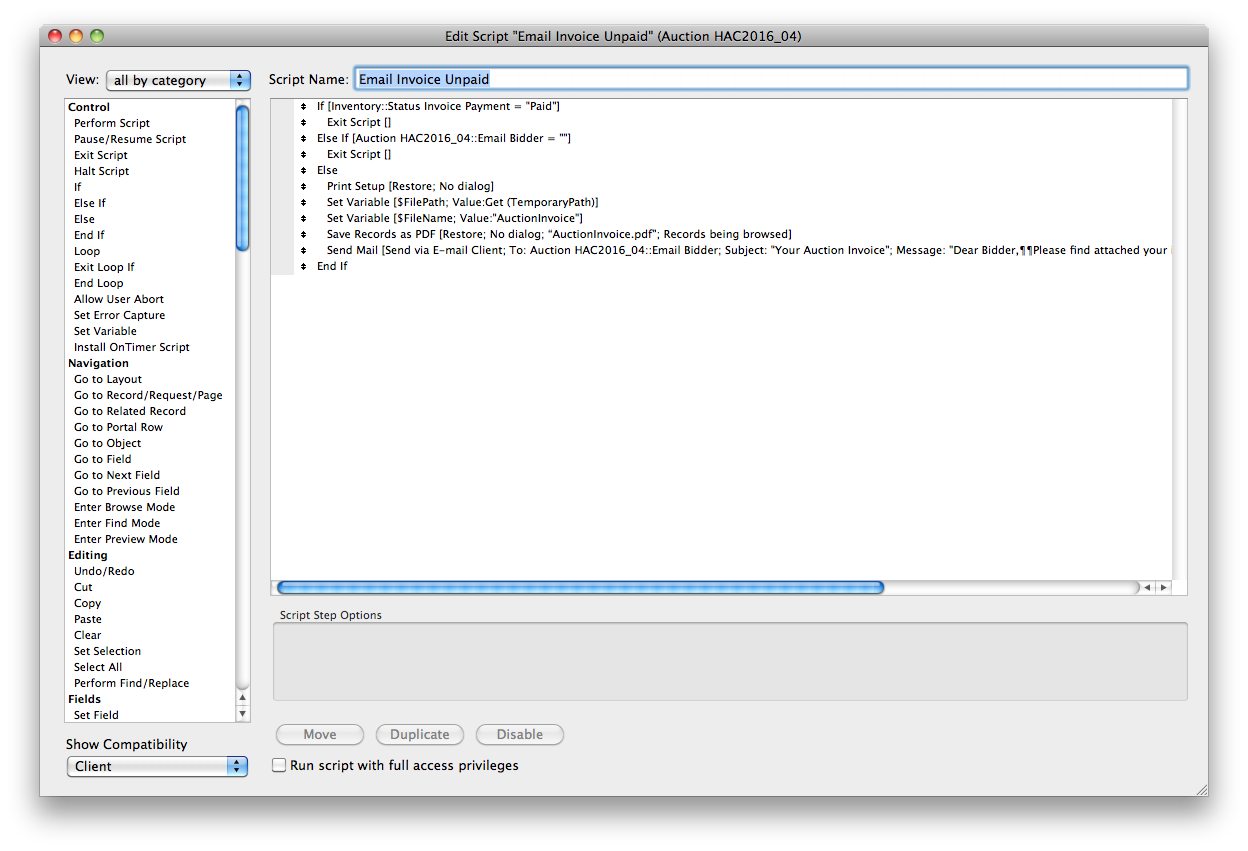

I have written two scripts to email invoices to customers. The first time I run the script everything works fine, but if I need to run the script again the emails are created, but only the final email has a pdf attached. If I close both of the databases involved the script runs properly again (one time). Any ideas? Thanks!

The first time I run the script it seems to take the time to create the pdfs/invoices. The second time I run the script in completes in a fraction of the time generating email with no pdf.

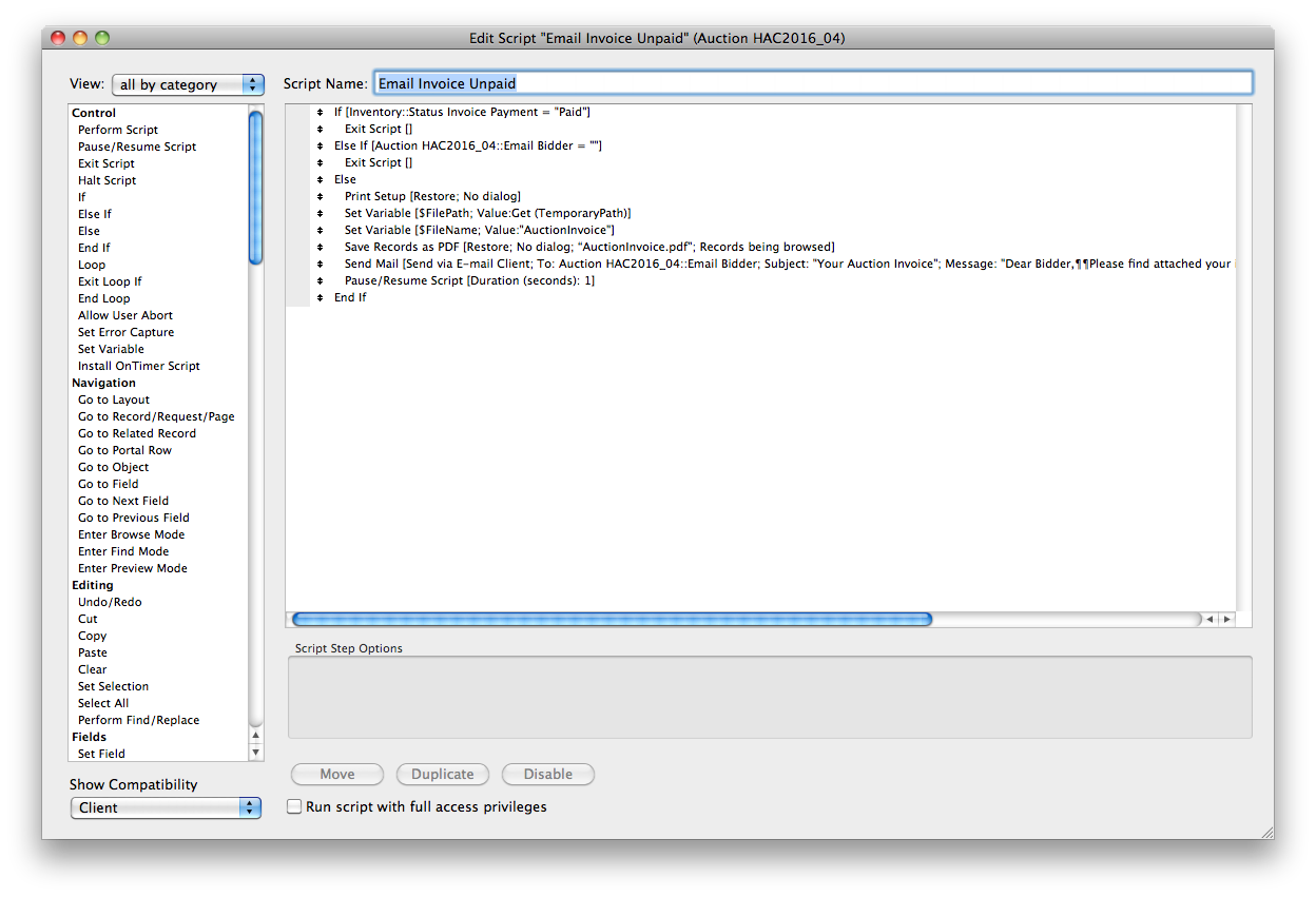

I stepped through the script and as I did so, the pdfs (should be one per email) were created on the emails. I am thinking that the script is running too fast to generate the pdf the second time around?

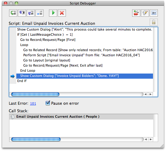

I put in a 1 second pause after the Send Mail step and that seems to have "fixed" the issue, but I am left with a curious error message in the debugger. 101 record cannot be found? I don't know what to make of that.

On a looping script I think you always get a 101 after the loop exits after last record.
The 101 error occurs because of the exit after last step in your first script (the fact that FM couldn't find another record triggers the exit after last).
You can eliminate it by adding Exit Loop If[ Get(RecordNumber) = Get(FoundCount) ] just before the Go to Record/Request step.
