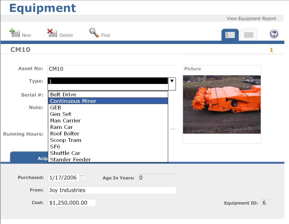

Hi again, i now would like to just ask some developer professionals ( Anyone on this form ) how they use drop down lists with normalized tables. is the only main method to hide the dropdown index with a name field on top. Also i was wondering if someone could point me to some code that when someone clicks on the drop down but not neccessarily on the triangle it would pop down the list. this just makes it so the autocomplete works for me. Thanks for the time. Patrick Glass
Thanks for the reply, i do have a drop down list with a name field over top of it. but the autocomplete feature does not work how i would like it, i want to be able to see what ive typed and have it do a filtering. Access has a much better solution for the drop down it seems. it will still only have the numbers to write in. i also have show only second field however if i were not to have the text file over top of the listview it would still only show a number of the ID value. Thanks
Hello, i am very new to FileMaker and this will be my first database. I am creating a maintenance Database for our company to organise maintenance reports. I already have a complete solution in MS Access. i found filemaker and loved the idea of being to be able to do data entry over the intranet. Now onto my situation. it seems my background in access had led me in the wrong direction. i currently have two tables, :Equipment -EquipmentID -EquipmentTypeID -EquipmentName ::EquipmentType -TypeID -TypeName They are linked on Type Fields ie CM11 is a Continuous Miner In access i had a combobox that would drop down and autocomplete the TypeName but on complete would fill the source field to be the index or TypeID field. in FileMaker i can do everything the same except i would have to have the drop down display the ID value rather than the text which is much less reader friendly. i have found a work around where you have a text box over top of the list and it would display the related value. The problem arises when we want to autocomplete the drop down. with this curent method it will only autocomple for the ID number and not the type of equipment. we have tons of datafields for the rest of the database of the simular kind so a robust solution would be very welcome. Well my real question is how are we in filemaker supposed to normalise databases if we cannot use ID's in an easy manner, should i convert all my ID fields to be text and just store everything that way, destroying all usefullness of a database. i am confused as how to get around this large situatiuon. Thanks for the time. Patrick Glass
