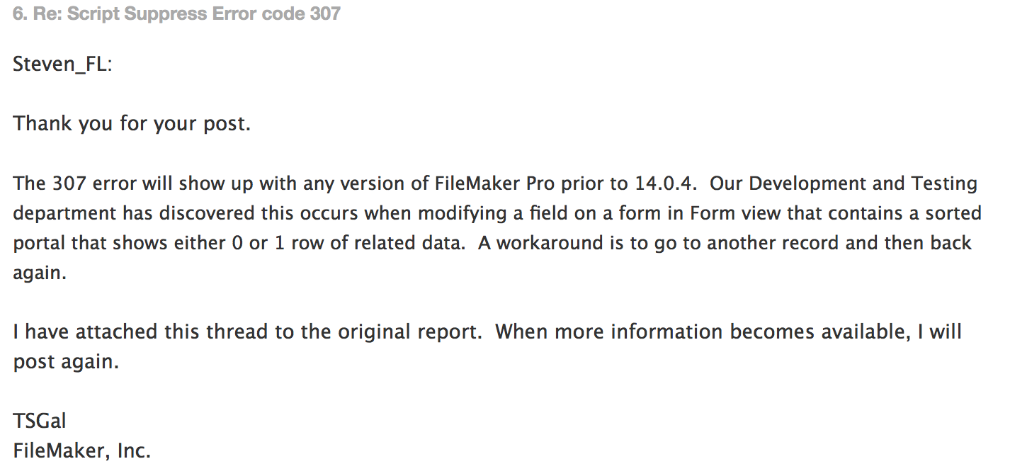

I am reading in the Filemaker Community for the following ... please see attached.  I am just trying to understand at this point.

To speed up the database I navigate to layouts across all my layout with a perform find initially ... !@#$ basically find no records then the customer select specific records ( could this be my issue ? )  I do have a portal on the layout and it is in "Form" vieew but I keep that at zero record until the customer selects them in a global dropdown menu to populate the portal.  Sound like it is the cause base on the attached message.  Anyway thank you, any assistance, guidances, links here will be grateful.
It looks like this could be a genuine bug; did the thread on TechNet indicate that it was resolved in FM14v4 or later?  Are you and your client running on the latest v-rev of 14?

Here is the response from Filemaker
The complete forum thread can be found at:
Error 307 FM 14 Server Upgrade?
This issue was addressed in both FileMaker Pro 15.0.1 and FileMaker Pro 14.0.6 when accessing hosted FileMaker Server 14.0.4 files.  If the clients are using an earlier version of FileMaker Pro 14, have them update to FileMaker Pro 14.0.6.  If the clients are using FileMaker Pro 13 or earlier, then consider moving back to FileMaker Server 14.0.3.
