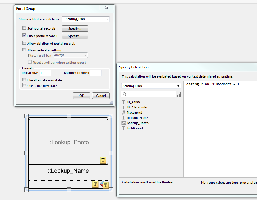

I don't think what you're describing can be done. I believe object names are only available to the script engine. But you could achieve the same effect via other methods, e.g., using the Initial row in the Portal Setup dialog.
