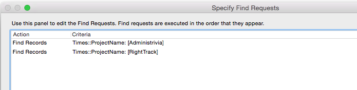

Do it as two find requests, rather than combining them in one as per above.
The Perform Find would look like:
Cheers
Webko

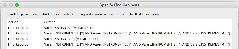

Thanks, Webko, but...!
I want it to output only if "Kategori" or "Kategori 2" contains the word "Instrument". My test (see attachments) doesn't do that.
Example: Catalog number BRIDGE 9450 outputs "Kammermusik   Klaver   Klaver   Klarinet    Fagot".
In my database "Kategori" contains "Kammermusik" and "Kategori 2" contains "Instrument".

Why does your test have four find requests instead of the suggested two?
I'm sorry, I do not know. It is as I had seen the proposal. Which 2 of the 4 should I keep?
[Edit] Ok, comment. I'm working and I think I'm going the reght way now.
Edited by Kurt Hansen
If you want to search the "Kategori" and"Kategori 2" fields, then those are the requests you should keep (#1 and #3 in your screenshot).

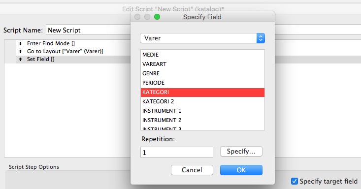

Please see attachment. How to select? My table has the name "Varer" and "Category" is "Kategori" in Danish.
[ YourTable::Category; "instrument" ]
7 minutes ago, Kurt Hansen said:
How to select?
Just click OK and Filemaker will insert the field name for you. It will look like this: Varer::KATEGORI. Then click the Calculated result: Specify button and enter the text "instrument" (including the quotes) as the calculation formula.
