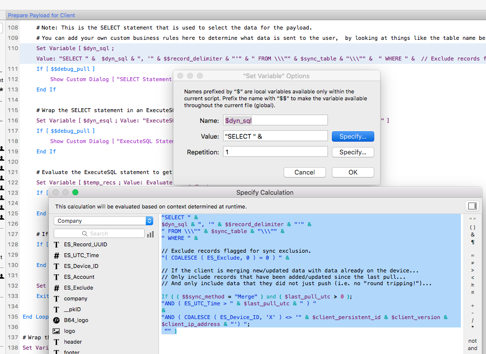

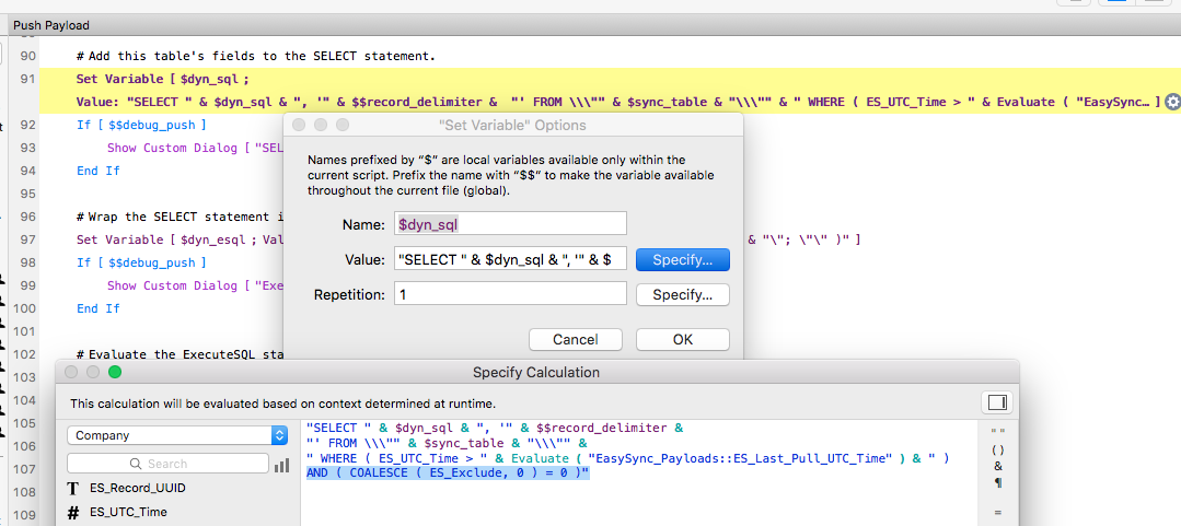

More about exclusions; there are 2 ways to exclude records from the sync.
1) Use the ES_Exclude field. Any record with an ES_Exclude value that evaluates to true will be excluded from the push or pull payloads. You can see that in the Push Payload script here:
2) The second way to exclude records is by modifying the $dyn_sql SELECT statement in "Prepare Payload For Client."
Modify this however you want. Want to exclude all Georges from the Pull?... Add "AND name <> 'George'" to the end of the SELECT statement. To exclude values that match your value list, maybe create a loop that adds a clause each time -- E.g. & " AND field <> " & GetValue ( $additional_info ; $i )" is added with each loop. You could technically add more conditions to the Push Payload SELECT statement too, but It's probably better to push all new/edited records and only pull what you need.
J
Edited by Joshua Willing Halpern
